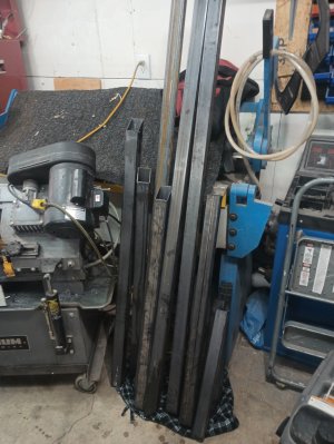

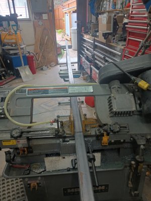

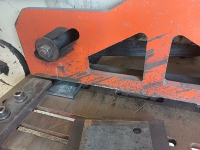

Cutting it up, and the stack of cut pieces ready to go

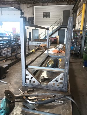

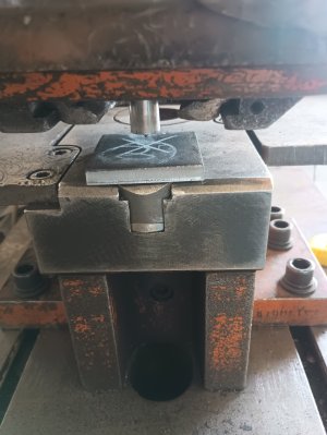

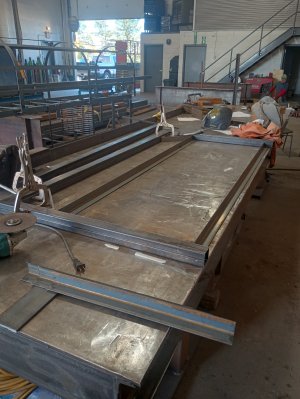

Took a trip to the shop of my main contractor, i don't have a table large enough or a flat enough spot on the floor, there are ways to do it with stands....but for what its worth might as well head over to the shop
Ironworker is great for rough stuff like the foot plates, chunk up the lengths on the shear, and pop the 11/16 holes using the punch

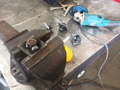

Welding nuts in for the adjustable feet, using 5/8 structural bolts, because there is a big bin that no one will ever use. Yea there is no guard on that grinder, it's one of the shop guys, not mine, I hate running them without guards (modified that is) for various reasons

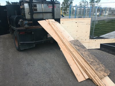

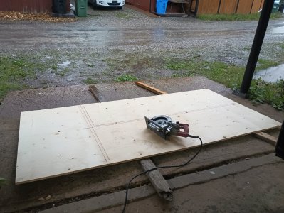

made it to home depot before tonight's monsoon for a sheet of plywood, cutting it up under the overhang i built in another thread, hurray for that!

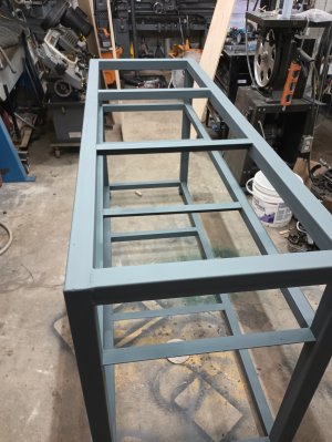

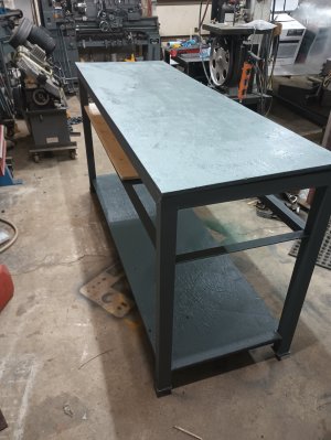

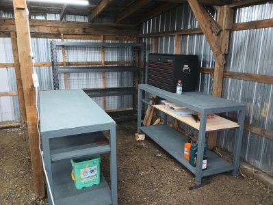

Welded out, painted, it looks a lot bigger in the garage than in the shop or at the hangar, funny how that works. Ran out of paint, so for now the intermediate shelf gets nothing, and im going to scavenge for the chunk of 5/8 to fill out that hole (in both benches)
total material for the 2 benches (including the left over, but new, i already had), 2 1/2 lengths of 2x2 (at 40$/pc), 4 lengths of 1.5 angle (25$/pc), 2 sheets of plywood (50$/pc), and 1 qt of paint (40$), total of 340$, I still need to screw the tops down, so lets add 10$ for that, 350$, or 175$ for each bench. I probably could have bought something for around that cost each, but i don't think they would be very stiff (important for the gravel floor), and probably not last as long

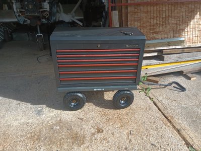

And scored this little cart at princess auto for 35$ and the tool box on marketplace for 200, I think its time to stop spending money on hangar stuff for a bit
Wow, I've seen flimsier lathe stands LOL. Looks great. What did you end up selecting for metal paint (and primer if that preceded it). How did you mount the ply top to the frame (if replacement comes one day).

For the paint i just used tremclad, its easy to get, and with some prep it does seem to hold up reasonably well. I did scuff it up with a red scotch brite and use wax and grease remover before hand. No primer, just paint, more for looks than anything else.
I was planning on using countersunk self drilling or if i cant find any of those i will go with countersunk self threading screws right into the hss frame and cross members, nothing to crazy.
Or maybe pre-drill the holes in the frame & screw it from the underside. Probably same end result but might be easier if you ever flip it over one day or change your mind & replace it.

I suspect the screws would pull out if i just went from the underside, its only 5/8 plywood, so might have 1/2" into the plywood, i found some wafer head self tappers, ill give that a go
there are lots of ways to build a welding table, if you wanted to have plywood on one side and steel on the other it would be as easy as shimming the plate up with flat bar, 5/8 ply on one side, 1/4 plate with 3/8 flat bar on your supports to shim it up. 3/4 ply 1/4 plate and 1/2" flat bar, etc etc. Mig or stick you would end up with little burn marks from the sparks and spatter, but i wouldn't be concerned about a fire, it takes quite a bit to get plywood going.
Most shop welding tables dont have slots or holes for fixturing, just a chunk of plate on a frame of some sort, normally at least 3/8 thick, ideally 1/2+, the constant tacking of tabs and other things to the tables warps the top other wise. Many things are also built on the floor or horses, you will never have a big enough table, thats just reality.
I have yet to see a fixturing table "in the wild", im sure in some very high end shops that do lots of one off expensive fabrication (Bikes, bicycles, aerospace, etc) probably employ them, but its not something ive seen, so not really something you have to have, but nice to have for sure.
How heavy you build your table is totally up to you, the advantage to a big thick piece of plate is that it is already quite flat and requires minimal framing, and will likely stay flat, but it is big, heavy and expensive. If you just plan to use it more as a ground plane, then just about anything will work, a chunk of 10g with some framing would serve in a hobby shop for many years, it wont be as flat and sturdy as a piece of 1/2", but it would be 1/5the weight, and probably 1/4 the cost. So look at your budget, what you realistically want out of the table, and go from there, lots of ways to skin that cat.

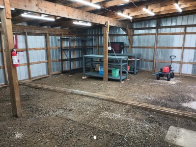

starting to look like a little workshop over in the corner, I think next up is a couple of "duck boards" for between the benches and in front of the shelving and ill have to keep an eye on marketplace for a few shop tools, bench grinder, vise, drill press, etc, that'll round things out
240w of led lighting seems to be enough, i think i will still need some task lighting, once monsoon season finished up here i will hopefully get the little taylor moved over to its new home, that should give me a better idea of what lighting is still required

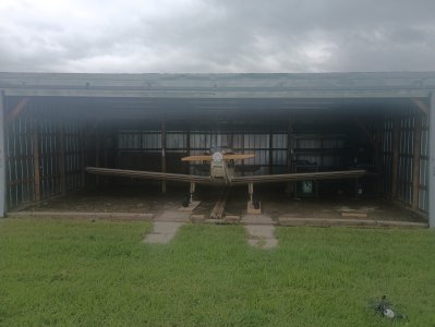

had a break in the weather and flew the mono over to chestermere today, finally in its new home, out of the sun, rain and snow
That short little 30-40 minute move took a full 8 hours to complete, drive to Vulcan with the trailer (1h5m), fill up the plane, preflight, warm up, 2 circuits and off for the the 30 minute flight, with pattern entry 40 minutes total (for the x country, 20 minutes in the circuit at Vulcan) land, talk with people there until the wife shows up....talk some more, wife gets antsy...continue talking, oops! Haha. Eventually pack the bird away and 35 minute drive home, hop on the motor cycle cruise back down to Vulcan, talk to some guys on the ramp...(There does seem to be a pattern here), load up the bike, drive back to Calgary, unload the bike, unhook the trailer....5.30, started at 9am 😀

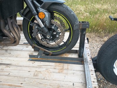

Made this little wheel chock for the trip... not really worth building at 120ish$, but I had the material and didn't want to spend the money for a likely 1 time use..it did work pretty well however, I'll have to squirrel it away some place
