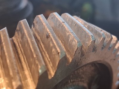

off she came again, opened it back up, for some reason the original (steel) cam drive gear was eating the original (aluminum) cam gear?? what the heck ? maybe the drive gear has some damage I did not/can not see? the bearings all look ok, no out of the ordinary wear any place else, strange

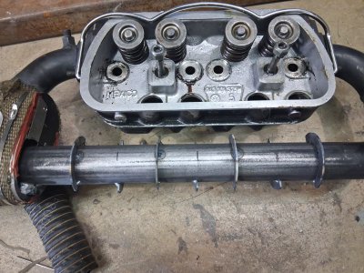

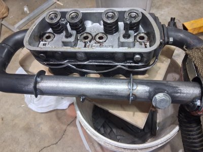

seeing as i was going to be down longer while i waited for various parts i decided it was time to see if i could improve the cabin heat/carb heat muffs, it would only blow luke warm air on the ground, and just not freezing air in the air, no good for winter flying
my idea is to have the air in contact with the hot header tube longer with some baffling to slow down the air flow and hopefully heat it up better
cut some circles out on the plasma table, cut in half and welded to the header tubes, i put half as many on the carb heat side, i dont want to much restriction, just a little more heat. There is an aluminum shroud around the whole works not shown.

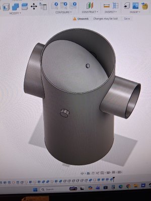

ive also drawn up and 3dprinted a new air box, the 3d printed version is only to get the location of the inlets/outlet, if the design works i will weld it up out of aluminum tube. I have a 3rd ?spiggot? printed out that will be the carburetor inlet, i intend to crazy glue it into position. Next time i have the lower cowl off for an oil change that will be the project

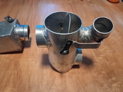

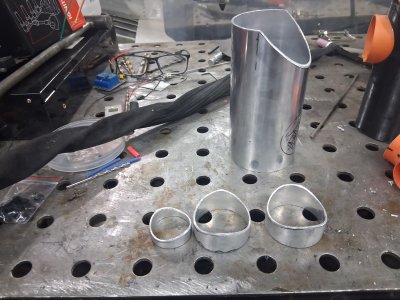

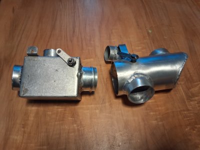

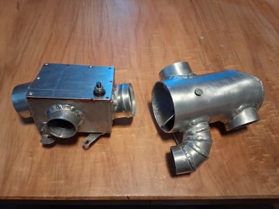

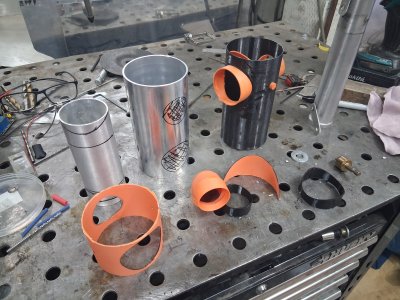

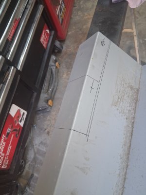

A few updates, finished up the new airbox, i was never really happy with the one i built. It was leaps and bounds better than the original, but still not great, the welding was trash, it squished the air filter between the cowl and engine, it looked horrible, it was likely restrictive for various reason, and didn't actually allow the escape of the hot air from the heat muff
the new one ended up heavier by 12g, the 3" tube i ordered was described with a 1mm wall thickness, what arrived had a 2mm wall thickness, i also used a 3/8 steel round bar for the pivot as i did not have 3/8 aluminum round bar, the pivot out of aluminum probably would have saved the 12g, oh well, we are talking about the weight of 2 jujubes (yes i weighed them out of curiosity)
The 3d printed prototype as well as various tracing templates to make locating and shaping the various bits quicker, easier and more accurate

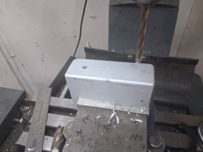

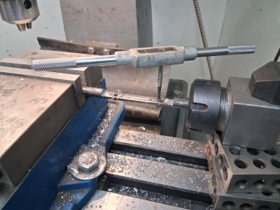

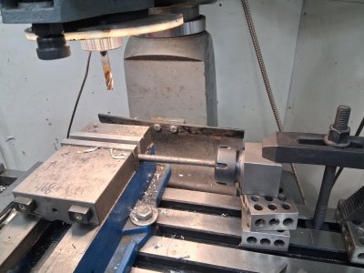

The setup for milling the flat in the 3/8 round bar as well as tapping the two 8-32 screw holes, I could have likely gone smaller, but decided on 8-32 as its a common screw size in aircraft
The finished product, I have succeeded to tig welding with readers, now the welding is closer to as good as i once was

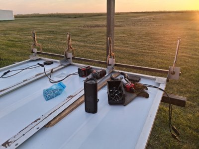

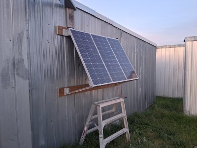

Part of the reason I did this little project earlier than planned is that i needed to mount the solar panels properly, they had been sitting on the ground as i originally didnt want to put any more holes in the rented hangar, the owner told me he was scared of breaking them when mowing and would like me to put them on the wall if possible. I looked at various brackets you could purchase online, and did not want to pay 70 or 80$, or really any amount of money.

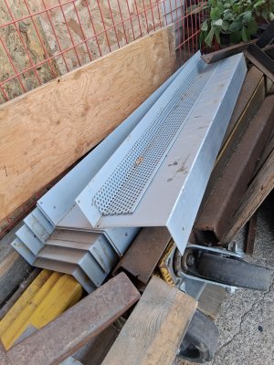

i have a whole pile of these aluminum things i scavenged from a job a few years ago, the material was to good to just toss. Along with that some 1/4 bolts from my bolt collection, and a piece of aluminum hss.
I made a bunch of brackets on the bandsaw, drilled some holes, bobs your uncle, 0$ spent for the bracketry
Went out after work to install the brackets, and mount the panels, i did end up buying 1 5/4 deck board and some cheap pop rivets as i did not want to use my expensive rivets for this. I think it turned out pretty nicely
