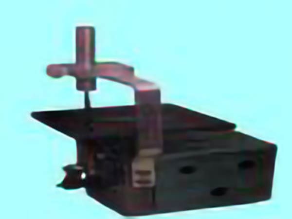

The advantage of HH design it's possible to run standalone or on a lathe. And not dealing with castings. And adjustable stoke. And a hold down system :)
damn you gerrit... now you've gone and convinced me to just make Harold's filer. At least to start.

Maybe I'll take this route, drawing upon the best design aspects of each that I have seen. But also adapting the mount to suit my lathe. I've now seen cross slide and tail stock mounted versions (like this one from Live Steam), so there should be no reason I can't make a one that attaches to quick change tool post for very fast change overs.
Live steam's below

Once you look around they're all over the place. I wonder is anyone has video of one they've made
The die filers with the over arm support can use regular files with a little bit of grinding
Maybe you mean the tang? I'm talking about the teeth of die file orientated asymmetrically so it pushes the work down into the table on each cut stroke (what you ideally want) vs a regular file pushing work down and pulling work up based on its typical file tooth. That pull on each upstroke would make keeping the work steady more challenging I assume. At least on heavier cutting. I notice some filers have a kind of clamp follower, not sure if related to this or a general safety thing?
I’m naively assuming the teeth are the same shape, just in a different direction relative to the tang, but maybe that’s wrong. The follower piece prevents the work piece from lifting up on the up stroke. The die filers with the overarm support should be able to hold regular files “upside-down” so the cut still happens on the down stroke, or atleast that’s what i’m banking on LOL
That stops the work from lifting. As Gerrit notes, without it, it will bite your fingers. I would encourage people to incorporate something into the design. You think you'll just be smart and it'll be ok, but its easy to get tripped up. Might be better in a lathe where you can control the speed, but the point in part is of to go faster than hand filling. I've found that clamp a necessary feature. The file is going at speed...and while the down force is the greatest there is still up-force. The small part starts oscillating up down without the clamp until.... DANG! that hurt. Its not really a clamp I guess, you just set it above the work to stop it from lifting.
