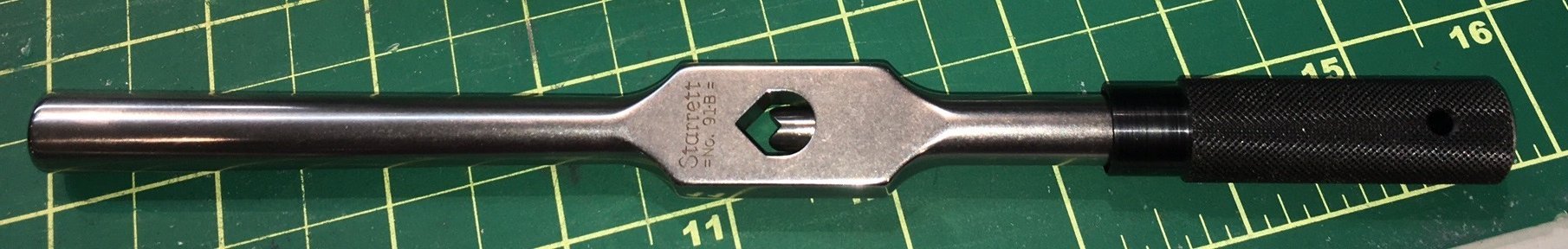

New addition to the toolbox
Looks gorgeous. Full report?
+ It's new
+ Yes it's gorgeous.
+ I spun the rotating cap handle off smoothly, there is no sign of machining residue
+ The plunger is spring loaded and moves freely so I did not bother to remove the retaining pin
+ I tapped a couple of holes and it holds the tap firmly
+ Heat treating / quality of steel, not sure how hard it is (I don't want to file test it), time will tell
+ I have never used one of the old ones, but overall it seems excellent.
+ ITM Canada free shipped it out quickly and for less than the typical used prices on eBay
