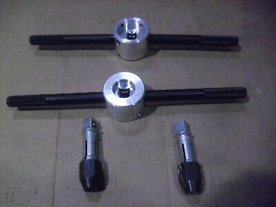

Honestly, if it were me I would study several types and styles, figure out what makes me smile about each design and make my own. Pretty sure the boys here that have made their own will offer some advice on what they like or don't about what they have. Whenever possible I like to make my own tools, not so much for the money saved as much as for the experience gained.

+1 on making your own. I made my tap, die (13/16") and chuck holders to fit the MT3 in my tailstock. The MT3 mount has a .500 shaft and the holders slide on the shaft. This works well with smaller (.250 and under) so if your doing bigger stuff you may want to try something a bit heftier.

Morse 354B die holder. Fits 1" and 1-1/2" dies, lots of meat so the locking setscrews don't strip, 1/2" square socket so you can drive it with a ratchet, 1/2" square to 1/4" hex adapter to hold in your tailstock drill chuck (or cut down a cheap 1/2" extension), removable handles. Mine is at least 50 years old, I got it from a machinist that retired in 2005 (when he was in his 80s). Mine is missing the original 1/2" square tap holders.
