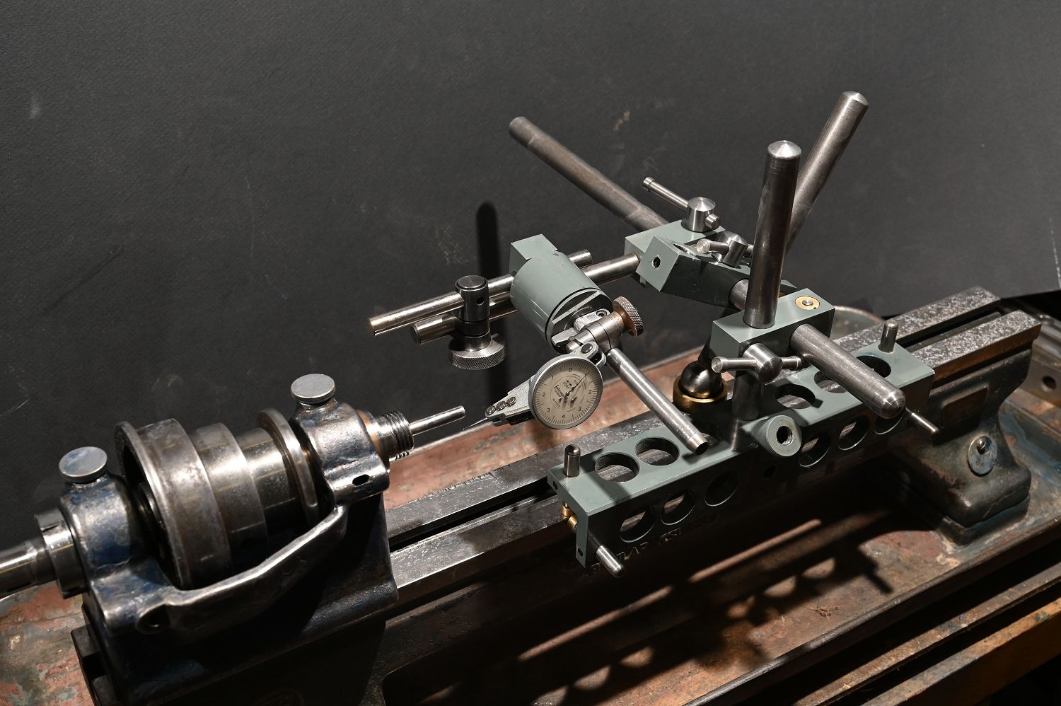

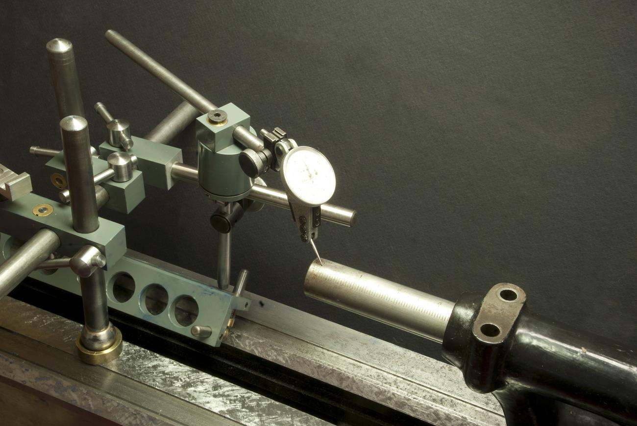

The best way to test for this is with a cylindrical test bar which has MT taper on one end to match your HS spindle socket. I bought a 24" made in India off Ebay for very reasonable cost. I was apprehensive but it is good value. They say cylindrically ground within 0.0001". I have no good means to validate that other than mic-ing down the length, but seems plenty accurate for hobby class machine HS & TS alignment work. Now with test bar inserted & cantilevered from the spindle, you can traverse an indicator down the length & this will tell you what's going on with regards to HS alignment - yawing in/out and/or pointing up/down. I have to caution you though, that breathing on the set screws can have a dramatic effect so proceed very carefully & only if you have a repeatable test bar. Maybe the factory omits mention of these adjustment screws so people don't start messing around, but that's pure speculation. With the spindle aligned to bed, then proceed to lathe twist (not the other way around).
I've read all the articles about cutting test bars & such. Nothing wrong with that & it has its place near the end of the procedure. Its just another means of verifying taper. You can save a lot of material & false readings by doing your best to initially validate geometry with test bar & indicator.
What I'm trying to convey is really quite simple. Upper sketch shows aligned lathe viewed from top. Zero bed twist. Lower picture shows the type of lathe where HS is mounted to bed & has the ability to be misaligned. It shows exaggerated HS angled toward rear of lathe, again zero bed twist. Would you concur the lower sketch would cut a tapered coupon?
This entire post is actually quite typical of many similar 'lathe levelling' posts one encounters on hobbyist forums. Its a familiar script. Someone notices they have taper cutting issue & the immediate solution offered is to jack the feet & twist the bed. The lathe type often does not even come up in in discussion as a qualifier. Or if it does, few people recognize that the HS is bolted to the ways & any misalignment there may well be the dominant if not entire source of taper cutting discrepancy. Then there is mysterious absence of the operator/parts manual even mentioning adjustment screws being there. If one has a larger lathe, say in 14" range, pulling the HS off & shimming is not exactly a trivial job although I recognize hobbyist skill sets vary. I'd certainly want to be sure before embarking down that path. Which is is exactly why a MT test bar is a valuable asset.
Just a guess on my part but maybe 20-30 years ago the chance of a hobbyist lathe being of the 'integrated' type (where no spindle alignment correction is possible) was certainly much higher than today. And yes, in that case you are stuck with what you have. Lathe twist is the only option & this presumes other factors like wear are good or minimal. But I would venture to guess a much higher percentage of hobby lathes in shops today are of the bolt-on style. Here is a popular vendor, quite typical of others including say Grizzly or other Asian importers. I count a dozen lathes from the smallest up to and including 14" swing which are bolt-on HS. Now if the factory did their job 100% and/or we have verified ourselves that HS is perfectly aligned in both vertical & horizontal plane, then we have arrived at the equivalent point of an 'integrated' lathe and hopefully relatively minor bed twist alteration may remedy remaining slight taper cutting. But if you have HS alignment problem & ignore it, and proceed to lathe twist, you are possibly attempting to fix the wrong problem or overcompensating which isn't the best solution. Of course this is a hobby so everyone is welcome to proceed as they see best. I'm just offering another perspective to the discussion.
Have a look at the picture I included in post#4 & the related description of how a test bar can be used. I attached picture of mine. Depending on your lathe you can use an MT sleeve adapter or just just buy the appropriate MT taper ended test bar. My spindle is MT5 so I use the MT3/MT5 adapter which I have confirmed is accurate. This allows me to use the MT3 test bar for subsequent tail stock work.
Pre-qualifiers: this relates to lathes of the type with removable HS where HS deviation is possible. This also assumes a newish machine with straight ways. The beds have not eroded away a hollow close to chuck. If that's the case, all bets are off, setup can only be a tradeoff compromise relative to chuck distance. Its an additional problem. And this discussion has zero to do with tailstock alignment. The TS must not be integrated into this initial test.
Personally, I think its best to get the bed as reasonably close to begin with even if it means somewhat undoing a prior setup. Why? because this is the very same datum surface that our DTI will ride along via the carriage when measuring the test bar pointing out into space completely independent of the ways. So as best you can, confirm the bed is not bending upward or downward relative to HS when viewed from side. And also is not twisting CW or CCW relative to HS when viewed from end. Unfortunately ($) to do this right is best accomplished with a precision level.
The test bar locates snugly into the HS MT socket and the extended portion exaggerates the HS axis relative to the 'mean' initial bed axis. Traverse an indicator down the length of the bar, both along the horizontal plane & vertical plane. We are attempting to discern if HS spindle axis is pointing inward/outward viewed from top and/or upward/downward viewed from the side relative to ways. If significant axis deviation is noted and dominated by the HS being mechanically out of alignment, that issue needs to be resolved first. If its a small deviation where we are satisfied HS alignment is as close as we will ever get, then we have arrived at the point of what I'll call the where classic methods like RDM come into play. The remainder of work is addressing lathe bed twist and ideally concluding with real cutting conditions. BTW if you doubt the significance of HS deviation as a source contribution, do the simple trig calculation for yourself. Consider a measly 0.001" over the length of HS block & extrapolate to the end of test bar. It translates into a significant amount of taper that actually represents a lot of equivalent lathe bed twist to accomplish. And something as measly as 0.001" HS rotation is nothing on a set screw, mere degrees of screw rotation depending on the thread pitch.
Here is my own summary. Others may have a different perspective. Taper cutting is a function of 2 somewhat independent sources. It could be 100% HS related, or it could be 100% lathe bed deviation related, or it could be some % blend of both. Unfortunately, the sources could serve to counter/mask one another or they also could cascade & exaggerate one another. Adjustment may well be an iterative thing, but hopefully by standardizing one deviation source (ideally the one with lesser +/- limits) in order to conform the more dominant or significant source, we can proceed logically & efficiently & not chase our tails too much.

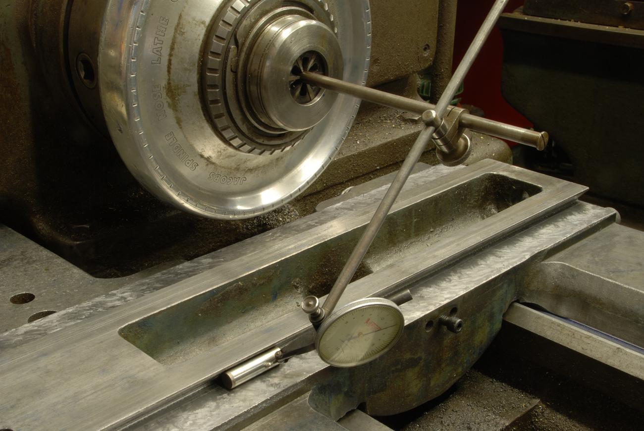

When you make, or at least remake which is what reconditioning is, the geometry of a machine, you need to follow a process that is exacting. There is not much equipment required, but if you don't have the right equipment, you get it, e.g. a Starrett 199 master precision level. Its different if you are just trying to set up a lathe; it's not realistic to say you have to spend $400-500 (and that's used) for a 199.
Which leads to a problem. I don't think I've used or seen a lathe upclose where headstock isn't solidly registered. They have all had inverted V ways or are pinned. You can rely on it (or least you could in the past) coming from the factory correctly aligned. This eliminated HS alignment as an issue.
One thing I learned here is that is often no longer the case. After watching how SM did it over a few days, I can see why manufactures would see it as a huge cost savings not producing lathes in this manner, but imo its a real disservice. SM had three guys full time scraping HS, TS and carriages in to the ground bed. Its imo the right way, but it is expensive.
Nevertheless, if this is your the current reality, you can't solve this problem without having a way to detect twist separate from HS misalignment. I haven't read everything that is here, but this challenge is no different than that faced by the person reconditioning the machine. The correct procedure is to remove the bed twist via leveling before working on scraping the HS in (HS alignment) because if you don't, any reading (or tests cuts) you make with the carriage moving over the bed, will be erroneous if bed has twist. If you don't have a 199, use the best you've got.
You do have an additional problem: wear. Wear can mean even with zero twist in the bed, relying on the carriage travel for detecting things relative to the headstock introduces error. There is little you can do about this, but one technique is to use a Kingway (or my version of it shown below which I think has several improvements) to slide along unworn surfaces. This is better than nothing and good for surveying as well, as advocated by scraper Richard King. (Having seen lathes been made, I do disagree with him as to how perfectly reliable these surfaces are or how exact their vectors matches those of the original ground surface as, at least at SM, they were done on different machines and setups than the way grinding).
A couple of other ideas. The best way to align the headstock, with the bed first leveled and a reliable surface to move along, is to mount a precisely ground cylinder, like a cylindrical square in the lathe. I say best because the error introduced with workholding doesn't matter. Weight reduced (holes) and a few inches in diameter is ideal. Just put it in the three jaw, alignment does not matter.
You take a reading at the chuck, then at the end - two planes. Then you rotate it 180 degrees and do so again. Looking at the differences between them tells the story. In my diagram, if A=B, its aligned. When scraping of course you have to do this in two planes, ZX and ZY but for checking alignment only ZY is looked at. Using the A=B difference method eliminates the need for test bars and eliminates any source of error in mounting - even the taper spindle mount introduces some error. You also want to sweep the indicator, not drag it along the work which can introduce error as the work may be going up or down hill in the other direction - see photo of sweep tool.
Despite all this, turning a long cylinder parallel to few tenths remains a BIG challenge. The only time I might take a test cut for alignment is with this type of job....wear, tailstock quill clearance and concrete slabs moving making things somewhat "dynamic". This is where figuring out what mounting bolt to tweak a few degrees turn pays off :)
