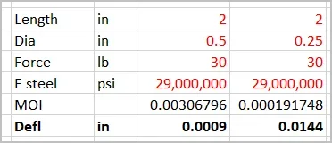

And I guess I should have said 'all other things equal' a larger diameter section deflects less 'in cantilever loading'.
