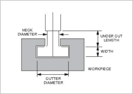

I'm looking to cut a t-slot. The slot I'm hoping to duplicate has a "TEE" section 1.156" wide (the bottom of the "T") by 0.218" deep. The throat is 0.750" wide by 0.187" deep (the top of the Tee is 0.187" below the uppersurface). The Tee slot itself should therefore be 0.406" wider than the neck (meaning the T-cutter needs to be able to cut a slot 0.203" deep.
This T-slot is in the Slide, Compound Rest Tool Post of my Atlas 618 lathe. I contacted Clausing to ask if they still made the part (M6-303). I received a very nice reply saying they no longer make the part, but supplied a copy of the original manufacturing drawing (see attached).
The only place I've found selling T-slot cutters is Amazon (shipped direct from China). Unfortunately, the t-cutter only extends 4 mm (0.157") (18mm cutting diameter, 10 mm shaft). I might be able to narrow the shaft of the cutter to allow the slightly deeper cut (I'm sure that'll void the warranty!!) and I think I could probably make that work.

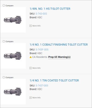

@FatherWes for what its worth I totally adree with @RobinHood, couple of years back I cut three 10" long T-slots in a cast iron plate for a friend. First I ran the proper sized end mill followed by the correct T-slot cutter from KBC. Very pleased with the T-slot cutter end results and finish.
My only advise is plan the job out meaning end mill to T-slot cutter, above all don't get rammy with the project.
Steady as she goes matey!
Thanks for the tip. KBC looks like a great resource - I knew there had to be a supplier in Canada somewhere!
And searching for 'key cutter' gives me a better fit for depth and width of the bottom of the tee. ( I had tried searching for a key slot cutter previously, but what I found was held on with an exposed nut below the cutting flutes (so it could not cut a flat bottomed slot). The ones on KBC site look like they should do the job perfectly!

Also gonna point out, that Woodruff Key cutter, is a different built beastie, than a Tee Slot cutter. The Woodruff Key cutter uses a curved shank which thins considerably near the cutting teeth, and is really only meant to withstand the cutting forces of being fed in to a shaft to the prescribed depth, to match the key it is for, on one side.
A Tee Slot cutter uses a straight shank, that matches the width of the slot, that the Tee is going in. You mill the slot to width and depth, (plus a little deeper, usually), and then you are stuck essentially taking it on faith, that your machine and set-up, are going to be up to the task, as you pretty much do all the undercutting in a single pass through the work. The straight shank of the Tee Slot cutter provides a lot more support for the cutter.

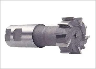

The straight shank of a Tee slot cutter provides support, by being at or very near, the diameter equal the width of the slot itself. Support. Stiffness. Resistance to flexing, ability to transmit torque, not breaking when loaded up with cutting forces. Clear enough? A 1/2 inch straight shank provides better support to the working cutting edges of a Tee slot cutter, than a very reduced, say 1/4 inch diameter shank at the join to the actual working bits of a Woodruff Cutter of similar dimensions.
A Woodruff key cutter (dragged in to this conversation a few times, earlier in the thread) has relatively, a much narrower shank for a given diameter, and thus, LESS support for the extended cutting edges it must drive. That is how Woodruff cutters became involved, and why I suggested that they are a poor choice for a tee slot! And why the are relevant to the conversation.

Maybe a picture will help explain how the tool shank itself helps “support” the cutter...
Look at the size difference of the shank material to which the cutter head is attached. In all cases, the cutter is 1.25” diameter. Only the width is different. None of the shanks will ever touch during machining; if they do, you have a big problem and will very quickly bust off the cutter head. Granted, the T-slot cutter could withstand the largest side force because of its sheer size difference (compared to the thin section of the #610 for example).
And here are 1” T-slot cutters by two different manufacturers (& the 5/8” from above for comparison). Again, the shanks are massive as the tool is designed to more of less hog out the slot in one pass. Maybe a little side step to finish, but not usually.
