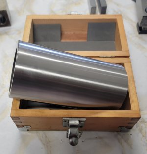

I think what you are looking for is called a cylinder square. A good one will allow you to check vertical squareness to a tenth or so across its length assuming everything is temp stabilized near 70 F.
I got one at a recent Kijiji sale. It was easily worth the entire purchase price of what I all got all on its own. It's in pristine condition. Didn't even know it was in there till I opened the box. Then I sucked in my breath...... I already had one I made many many years ago, but it is neither as big nor nearly as perfect as this one.

After over 25 years of wanting one, I finally bought a cylinder square... Now I need to make a squareness comparator!

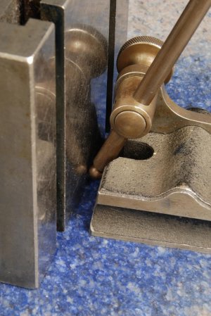

I think our conversations are ships passing in the night. My understanding:
- you need a specific type of stand, lets call it a squareness comparator (any of the pics in my post #25). But they look remarkably similar to a surface height stand with an added curve feature on the base
- you need an accurate reference block, could be a cylinder square like @Susquatch shows, could be a purpose gage block, anyway has known/graded perpendicular surfaces
- calibrate the squareness comparator to the reference block by zeroing the DTI or whatever instrument. The 2 tangent contact points are exactly like the prior calibration step: the rounded surface on the stand base & the ball of the indicator
- now bring this calibrated comparator up to the object we want to check squareness. Dial now indicates extent of squareness deviation. For example picture, he may be checking his 123 block but object could be anything
If I'm off base let me know. That's why I'm asking

You suck ;) (I'm really jealous) Nice find!

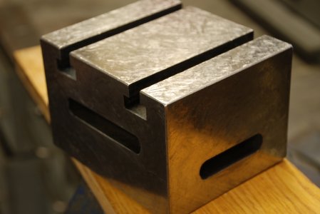

The first photo is mine. There is no curved base, you use ball at the bottom the mast - that's what it is for. I've never understood people set about modifying height gauges when most probably everyone as a surface gauge with this feature already built in. With a good swiss tenths indicator and plate, its how you work to tenth in the home shop.
btw, this a technique that can create squares from nothing, either via grinding or scraping. The key is the two opposing sides have to be parallel (not hard to do by grinding or scraping). Indicate each and you can figure out how out of square they are to the bottom surface.
here's a shot that shows it better....and the finished block, everything parallel to a tenth via scraping and square to a tenth over 6". All done via comparison, i.e. you don't need anything square to create this
