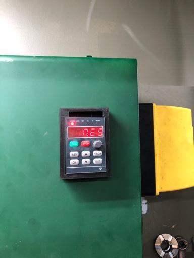

This thread inspired me to wire out the Emergency Stop (ES) input on my mill VFD to see how it behaves.
I'm not liking what I'm seeing. It stops when you trigger the ES but carries on where it left off when you remove the ES input. The display does not indicate anything unusual. I would prefer if it stayed in an ES state until both the ES and FWD/REV signal were removed. @kevin.decelles or anyone else for that matter how does your ES behave?

My ES switch stops the motor and when u release the motor starts again.
While it is stopped my display shows this
But if u turn the switch to stop WHILE it is in es, it will stop
Basically, it will return the machine back to the state represented by the switches
