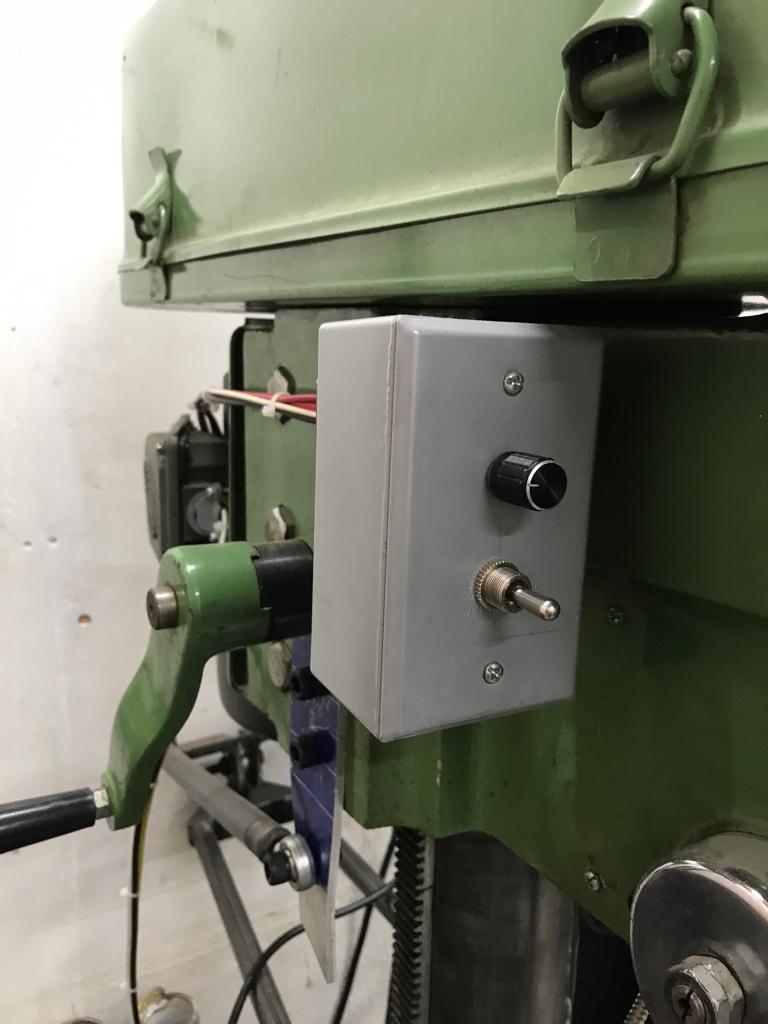

Ok I'm rethinking my idea of remotely mounting the vfd keypad on the machines. I will have the vfds enclosed in a box but am thinking that I might be just as easy to use new foward/off/reverse switch as pictured and a little separate potentiometer.
The keypad won't be used once I have it programed with remote switches as described above right?
What specs (resistance?) Do I need to have for a potentiometer?
I'm thinking the fwd/off/Rev switch would take the place of two separate switches, instead of one for on/off and one for reverse/fwd. Am I missing something here?

I have a very simple 10K pot and a SPDT switch. Works perfectly. Once programmed I never had any reason to touch the VFD.
This is my arrangement.....
The VFD key pad, display and POT aren't removable. Since it didn't support rev from the key pad I added that REV/OFF/FWD switch (from PA) as an external input. Once you tell the VFD to use external inputs it stops obeying the key pad run/stop/jog keys. The big paddle ESD switch interrupts the input power to the VFD. I'll probably change that arrangement such that it triggers the VFD's ESD function and wire in a on/off switch to interrupt the input power.
