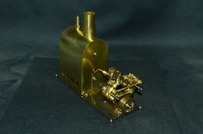

Looking at the pictures again it looks more like a holding tank than a boiler,,,, no fire box. What do you do, build a campfire under the tank, lol
