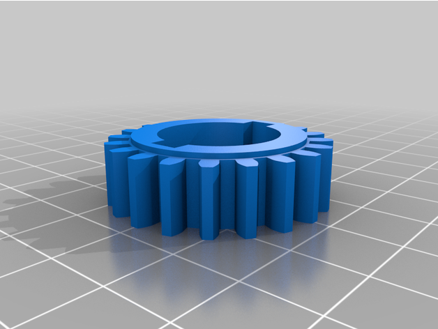

If you have access to, or know somebody who has access to a 3D printer you can find models for the change gears. This was the first one that I found and at a glance they look reasonable. There's an old Mr Pete video where he shows a set of 3D printed Atlas change gears and iirc they worked fine.
