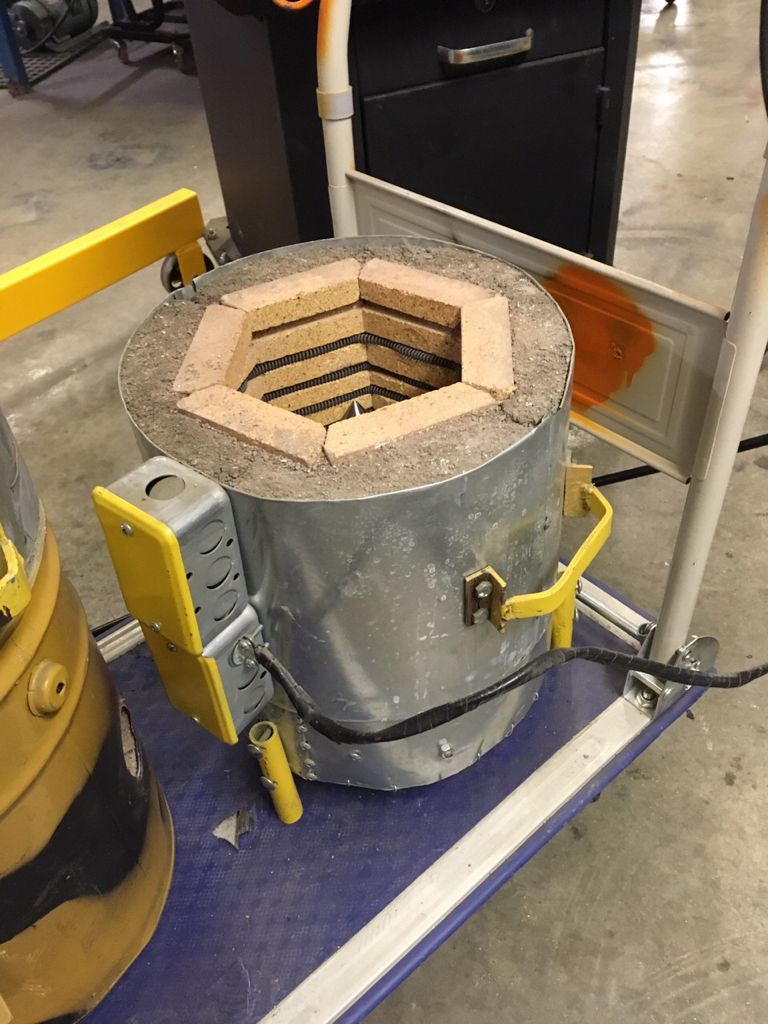

I am considering purchasing this kiln so that I can refit it as a furnace. Any thoughts on this would be great.
I also picked up a PrincessAuto 500,000BTU burner.
Now I was originally going to go traditional with the can lined with fire brick and mortar but I came across this kiln and thought this could work. Hoping for feedback from the PRO'S. Thanks in advance...

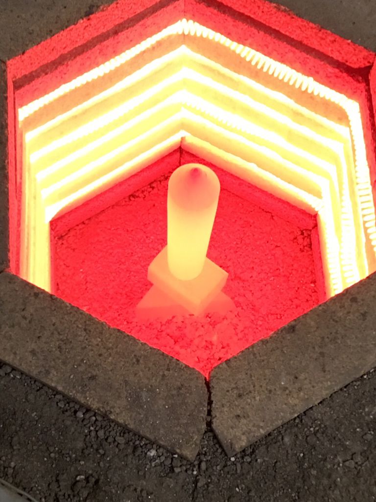

I use a homemade electric kiln to melt in the winter months, it'll work fine for aluminum
In the photos above, I was using it to anneal a hardened center so I could machine it easier
My assumption is that your kiln was electric...... I don't know if the firebrick will withstand a burner.... my firebrick was the hard type, some kilns have the soft brick which does t hold up as well
Looks like the stuff they have at KMS once in a while. I just have few bricks and a home made propane burner to melt some aluminium. Maybe if I use it more I get something more professional.
My furnace has a base, middle and top section. I have another middle section that is just refractory (no brick) that accepts a burner, I just swap out the middle when I want to use propane which is as soon as the weather turns warm
Just got in from picking up my kiln, and I didn't have to sell a kidney to get it.
$20.00 What a deal!!!
My kiln has no electronics and I need to make a burner. Some tips for this would be appreciated.
I did pick up a brick sample from a local supplier. 9"×4.5"×1.25 very heavy for its size and the supplier tells me that they are used for pizza ovens. It cost me $2.00
I made a Reil style burner (just google reil burner -- pour a nice beverage and have a good chair because there is a lot of video on the variations). I used 1" gas pipe with some brass fittings etc. The only 'special' tools is a specific 'numbered' drill bit for the propane. I made my flare from some sheet metal.
I bought some of those light weight, super high insulating bricks from this place. They are used to build custom ceramic kilns which I imagine is more in line with molten metal requirements? I think they sell the HT mortar as well http://www.ceramicscanada.net/
I'm just using them as background insulation to torch up occasional tool steel, I know zip about the molten metal business. But I think 'fire' bricks might be one of those - means different things to different people. I'm pretty sure the heavier ones you see for lining fireplaces etc. are not the same as kilns?
I use the light white bricks for melting pots from time to time they work great but can be very brittle and require gentle handling, molten metal does not stick but dross and other contaminants will
