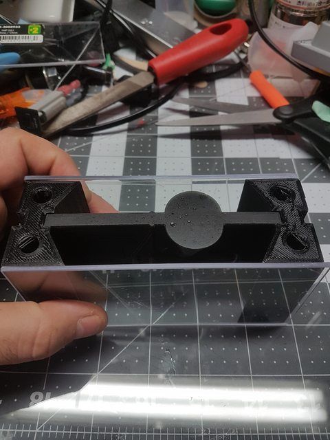

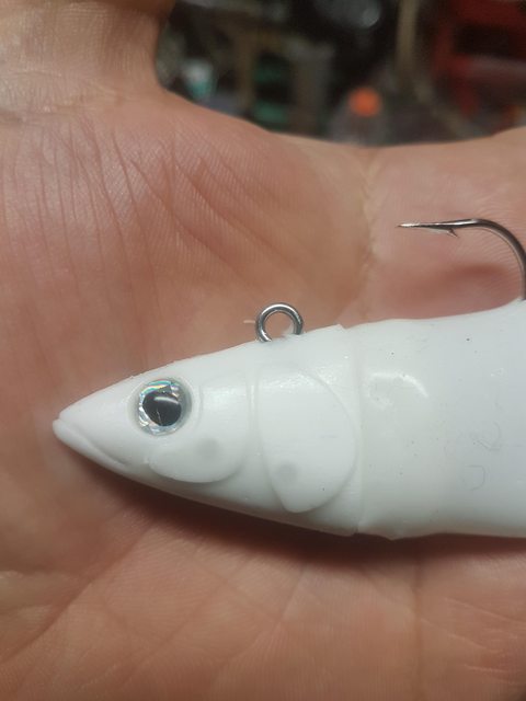

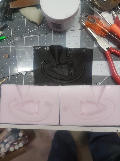

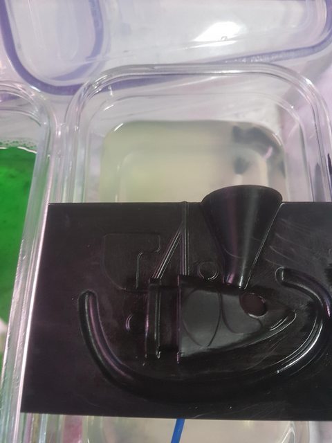

Ooo, that's a new guy I haven't found yet. Looks very promising, thank you very much for sharing. I'm looking forward to learn more from another source. I've 3d printed matchplates before for silicone molds for fishing lures, but not for casting metal. It's something that I want to pursue, but will have to wait until I build a few more better flasks. I'll work up to it.

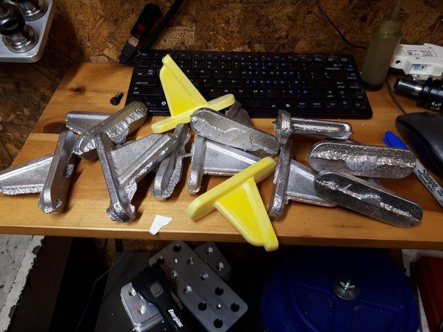

Here's a few shots of that project from a couple years ago.

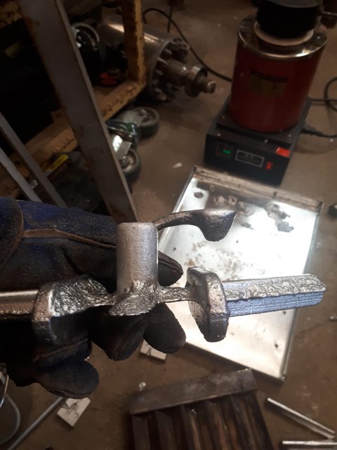

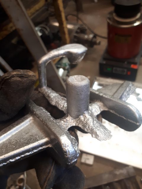

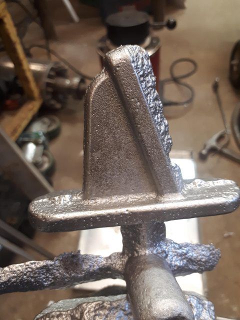

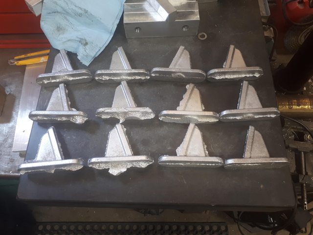

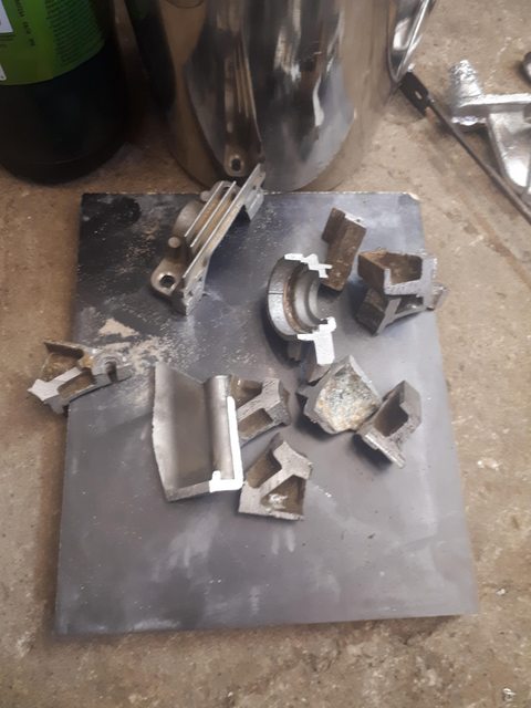

So, after ramming up another mold with better gating, sprue and risers (I think anyway), I just finished pouring it, and the results were MUCH better. I think my sand is starting to be a limiting factor, so that will be remedied moving forward, but I feel like I'm making progress. I had some corner blowout on this one, but they are both on machined surfaces, so I wasn't too concerned. Still have porosity on the outer corners. Not sure if it's due to sand, or turbulence in the mold, and I need to rethink my gating situation. I don't degass my pours, but there are a lot of you tube casters that don't degas either yet don't have those problems, so I'm thinking that's not the cause. From my limited knowledge I think it's from having my sand too wet, but my sand it too poor it won't bind properly until it feels too wet.
I'd be embarrassed to sell these as a finished product, but for what I need them for they will clean up just fine. I need 12 of them, so I hope to make some incremental improvements and try some new things over the course of the next 5 pours to see if I can better my results. I'm finding it really hard to split the mold after ramming the cope too, which is where I think I'm dropping the corners off. More draft perhaps on patterns moving forward wouldn't hurt either, as well as taking them to the paint and filler stage too, but my flask key design is pretty poor and tough to smoothly separate. I'm going to be making some new ones shortly, so will rethink that area for sure. I'm fighting problems from a few different issues it seems.

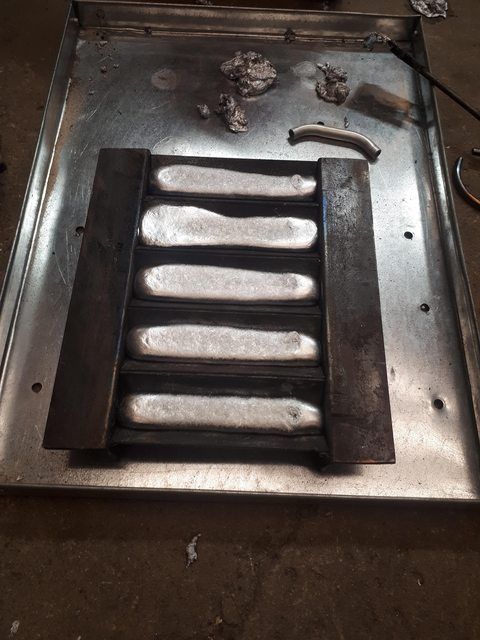

I finished melting through my bucket of scrap and poured 2 more melts of ingots after that mold (and a butterfly for my daughter) before taking a break right now to make dinner. Not sure I'll get back out there tonight for a few more pours or not. Enough rambling Dan, more pictures...

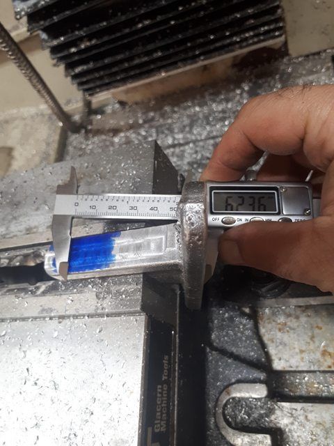

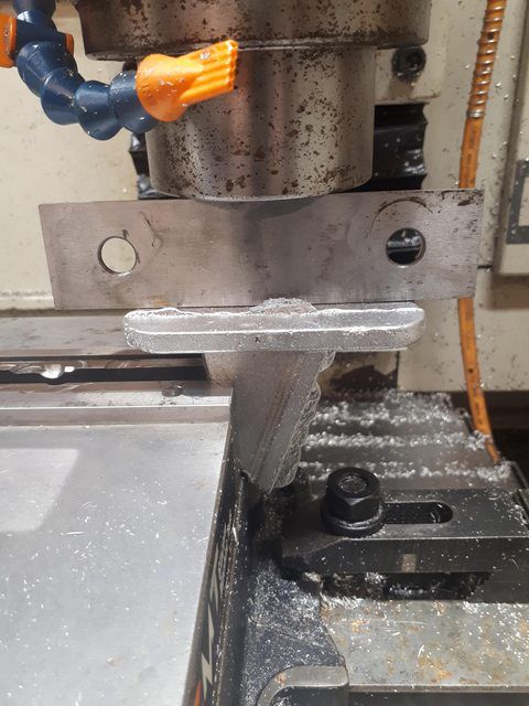

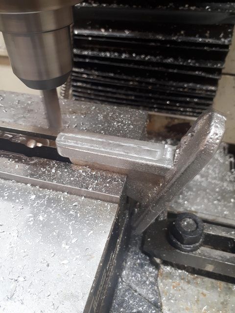

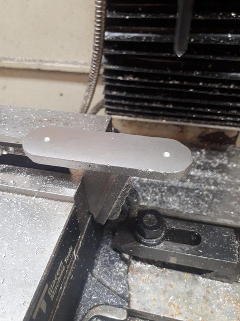

After dinner It was coin flip time. Cast the rest of the pieces I need, or machine the 2 good casting I have. I skipped to the good part and fired up the mill. 😀

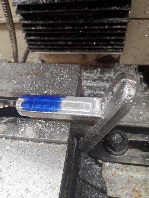

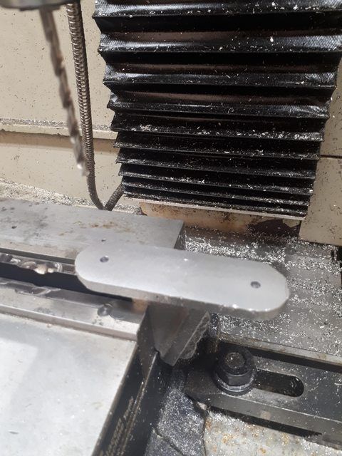

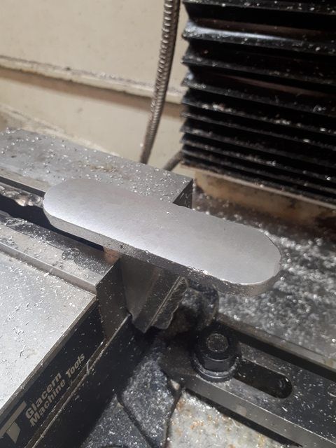

I should have planned this better and left a bit more holding stock for this op. Turned out ok, but I babied it. Used the spindle housing face (NOT bearing face) to align the lightly clamped part with a parallel, then snugged it down.
I chewed the bulk of it down with a 10mm 3lf, then I licked it clean with a fly cutter (Don't have a face mill for the tormach yet. Maybe my next build????). I picked up the center with an edge finder, and drilled my clearance holes for a #8 woodscrew.

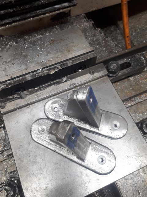

Then I did a repeat of the first op on the angled face. A bit more to hold in this op.

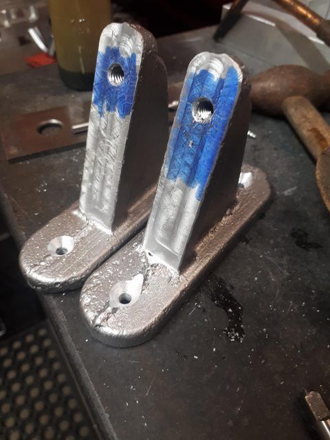

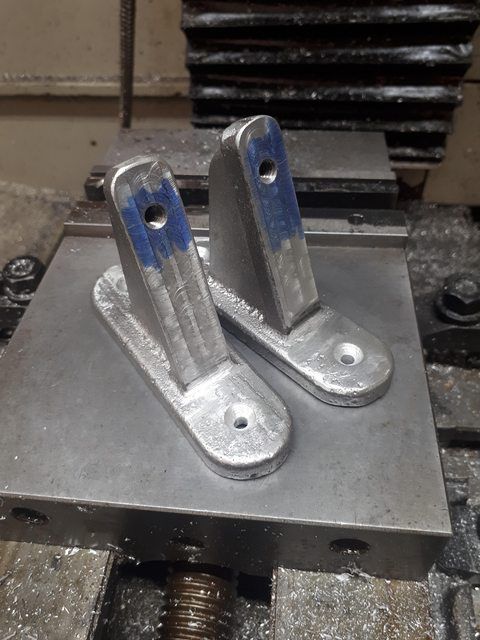

Next was laying out the x location of the 1/4"-20 hole. I snapped a quick pic from cad of the critical dimensions, and layed them out with a caliper and scriber. Then picked up that line with a single lip scriber. There are no really critical dimensions here, so no need to get fancier than this. I retained the y from the previous setup as I was holding the part the same way. Good quick and dirty time saver tip. Save the time and fuss for operations that matter, and you can really speed up your throughput.

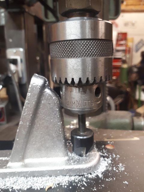

All done in the mill, I then tapped the holes with the cordless drill, and countersunk the holes in the drillpress. Clearance is clearance 😀.
Both parts milled it was time to clean up some flash with a flap wheel for the big stuff, and a few different flavours of files.

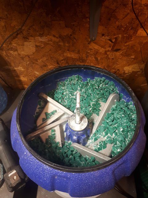

Done, they looked ugly and rough in the beginning, but cleaned up pretty presentable after a bit of work 😀. I'm kinda curious how they'd come out of the tumbler if they'll fit. I'll try the next set.

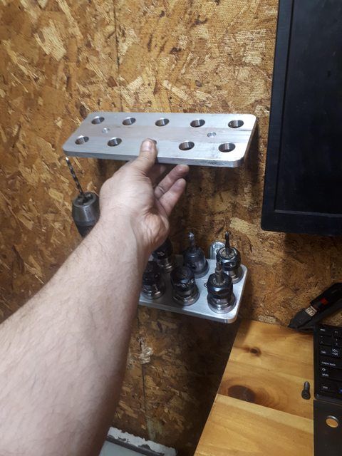

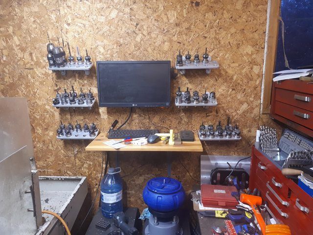

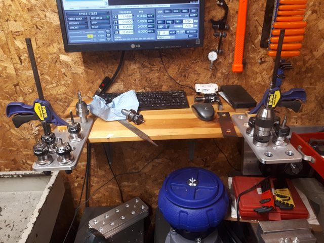

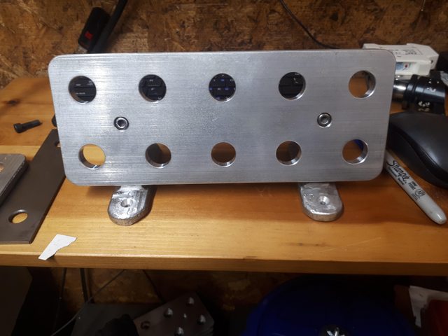

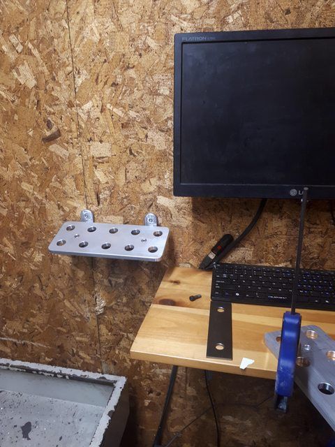

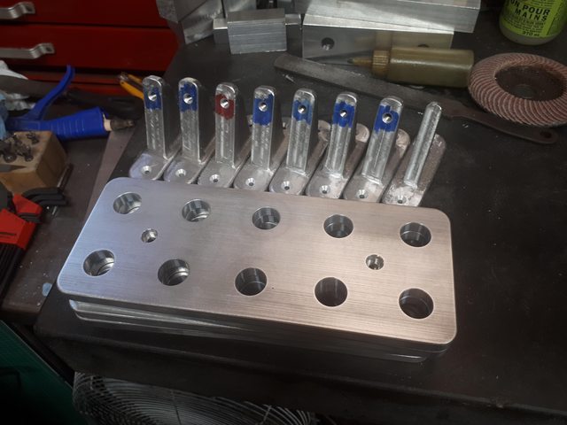

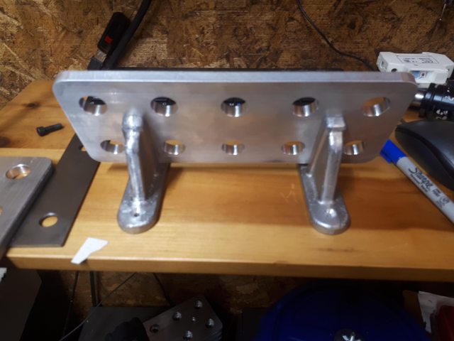

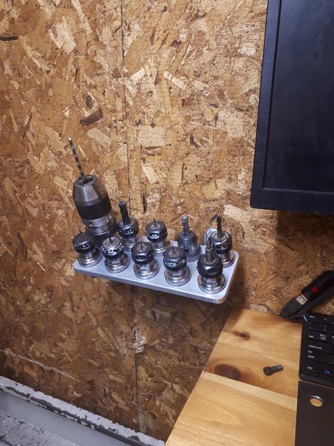

Back out to my shop It didn't take me long to get them put together and mounted on the wall. These should help clean up the mill control area. As you can see I've been temporarily using them for a bit already 😀
I still have 5 more sets to cast and machine (3 racks for each side of the monitor), but I'm pretty happy with the results of a weekends worth of work. I'll chip away at them through the week. A bit more effort and learning on the casting side of things, and I'm really looking forward to what is possible in my little shop now. I could have machined them all from barstock by now, or designed them different, but that wasn't the point of this exercise.

Don’t be afraid of using Parting dust and painting the parts fills the filament lines that will grab sand during ramming.
