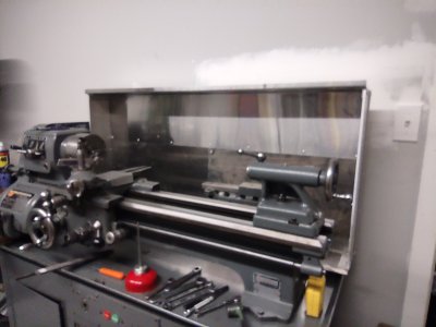

finally got a chance to put every thing together with the rivets. My take away. Less is more when using the air river tool. Also use the right drill and length of rivet. Even with my best effort I was all over the place with the rivets. I think I was driving them at weird angles. Any ways the back splash is done just need to mount it. Used some scrap stainless I had and some aluminum I had in my junk pile. I will definitely not win any awards for the riveting but it is all together and I can use that experience in doing my Christmas project for my dad.

My training in running either end of a solid rivet (bucking bar, or Rivet gun) tells me that it takes a fair bit of experience, to get anything like a consistent result.
Sorta like the kid who asked a guy on the streets how he could get to Carnegie Hall.... "Practice!"
We drove, quite literally, thousands of rivets, during our training and practical sessions. Some were ugly!
Cleaned up and finished mounting the back splash. So one project down. I have the aluminum pieces cut for my dads project see how the refits turn out on the next try.
