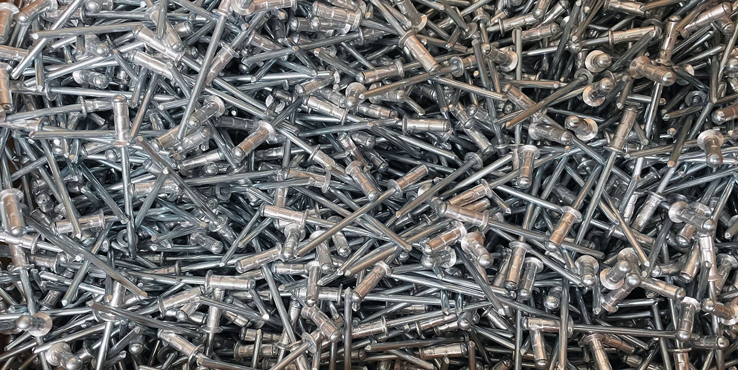

I have wished before to find a source of soft iron rivets, no luck. They are about like binding wire. I do have some steel rivets , but they so much stiffer than soft iron I didn't bother trying them. All cold worked? Even thought making my own (temporary insanity defence)
We bought these from Spaenaur a few years ago, for some repair work. Extremely malleable.
