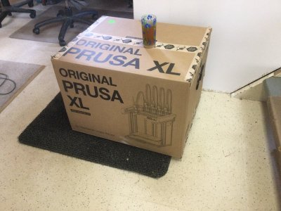

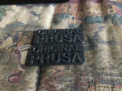

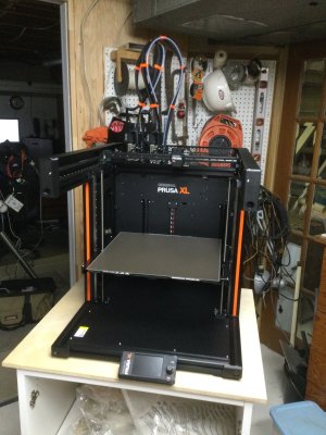

Me too. Received the Prusa XL on Thursday. Finished assembly last night. Now it is time to put power to it.
