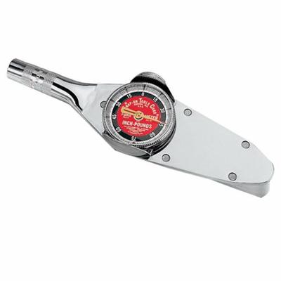

I have a few of these Snap on units in 1/4. and 3/8
and one of these in 1/4 drive:
Snap-On vs. the Amazon black box special. Aesthetically this is a bit like a Ferarri vs. Yugo comparison.

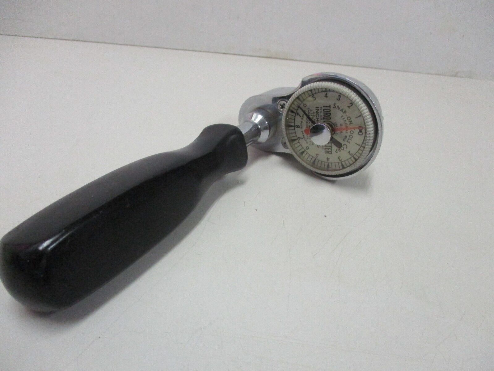

One of the Snap On torque wrenches i have is a non ratcheting, fixed, electronic unit. Called an electro tork. I picked it up for 20 bucks on Ebay. List at the time was 2k usd. The person selling it didn't know what it was.
