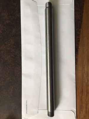

The threads are both RH on each end. No need for LH threads. Got my drill rod Thursday from KBC. $52 (all in, frieght, tax, etc) for a 1m length of 15mm ground drill rod. Checking with a mitu mic shows the diameter to be very uniform as expected. I went with KBC as MSM in YYC doesnt carry anything larger than 3mm ground drill rod and their price to have something similar brought in was considerably more than KBC.

Finished shaft:

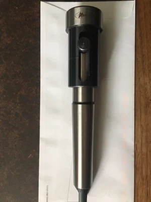

I ended up using a 'floating' tailstock die holder to do the threads instead of single point threading them.
My neighbours CX709 lathe has metric dials. This was my first lathe project since high school 30-ish years ago, so between re-familiarizing myself with 'touching off', 'zeroing' my dials, and the switching back and forth between metric and imperial (my mics are imp) in my head was confusing and I screwed up my first two attempts. Good thing the 15mm drill rod I got from KBC was 3 feet, lol.
I should add that my neighbour had a bag of the standard 'blue' (BusyBee/KMS, etc) brazed on carbide tools that came with his used CX709 which were all size '8' (1/2" shank) and he was using a jury rigged set of shims to set them to the lathe centerline. This didnt look right to me, so I did some reading and it seemed that I needed size '10' tools (5/8" shank). A quick trip to KMS and $30 bucks later and I had teh correct tooling to do the work without screwing around with a bunch of shims.
I
View attachment 21781View attachment 21782
The MT3 taper needed to be 'set' in the tailstock quite firmly for it not to spin while threading. This was one of teh screwups I encountered. Also, I should have remembered to chamfer the ends of teh shaft after turning the shoulders down to allow the die to bite in more easily. Lessons learned for next time.
I confess that I am shocked that it spun. Usually tapers with the tang tip do not (actually can not) spin except for a few degrees when the tang catches.
And before anyone jumps on me, yes I know that's not the purpose of the tang nor good practice, nor would I ever use it that way.
It is just that I am shocked and find myself wondering how that is possible.
I
I spin my MT2 tailstock tapers all the time, it's quite annoying. Not all tailstock spindles provide a means to utilize a tang.
