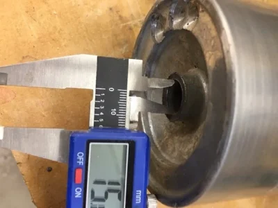

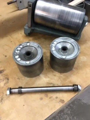

The inner shaft has two aluminum drums that fit over it in a very close fit. So it *needs* to be 15mm. To clarify:
Below is a pic of the sub-assembly from an identical sander I'm also restoring. The two drums and shaft in the foreground are from the unit I currently has disassembled.
The caliper image is cut off, but the el cheapo calipers read 15.05mm

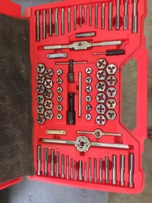

I suggest turning the ends down for the threads to 0.495 and then just using a die to thread the ends 1/2. 1/2 NC (13 tpi) is more common so easier to find beg borrow than 1/2-20. Acklands granger has (or had) a good tap die set for not too much money.
I picked up this on kijiji used for $100 last year, so not a problem. Of course I've already had to buy 3-4 dies that werent in the set for odd sizes. I got tired of junky T&D sets with poor quality tap and die handles, etc. This set is vastly superior in quality to the cheapies I've owned in the past.

The "2 halves" denoted in the above schematic are a slip fit on the 15mm shaft. Their OD, roughly measured by me in a pic above is 15.02mm or so. I have some inside snap gauges arriving today to get an accurate measurement with a micrometer for my own interest.
The two 'bushings' noted as '6' in the above diagram are also slip fit on the shaft and act as spacers. The shaft then has a bearing on each end that is an interference fit denoted by '5'. FInally there is a nut on each end of the shaft denoted by '4'. When the nuts are tightened to spec (not sure on the ft-lbs yet, need to find that document) the bearings (5) squeeze the 'bushings' (6) and teh drums (two halves) together as a single rotational unit.
