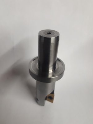

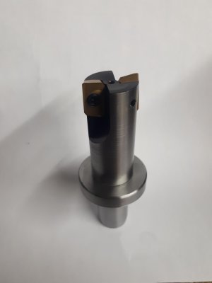

I bought the 1" accusize version a couple years ago. I hard turned the shank down to 3/4", and pressed on a TTS stop collar. I've been impressed with it, and have had no issues with it. I also have the 2" face mill that uses the same apkt 1604 inserts and it's nice having shared consumables. I will at some point pick up a smaller one that uses the smaller inserts, but for now I'm good with this one. I still need to make a TTS shank for the face mill, but use it a lot with an R8 one in the manual mill.
I'm not there yet. Tooling up with yet another insert size for steel, stainless, and Aluminium with small and large noses (6 boxes of 10 inserts) pretty much stops me cold. It's easier to buy a few more hss and Solid Carbide endmills in the needed size range - under 1 inch. Maybe in time, I'll change my mind.
Ya, when I was running the CNC shop I didn't see much value for what we did in insert tooling below 3/4. Solid cutters were better and more versatile. I'm sure there are different applications where it would be the better choice, but for our work and machines it didn't make much sense. My only interest in them at home is purely from a novelty standpoint lol. Like the fact that most fishing lures are designed to catch fisherman.......
I made that one. It's been a while, but I think its 4140 (maybe o1?) and I think I hardened it. That was one reason I went with the 1" version was so I had a step to press the collar against. Not sure I'd trust a bolt on collar, but I have unfounded trust issues for stuff like that :D. I'm sure it would probably work fine if one didn't slam tools in and out and was careful with it. I'd always worry about the pullback force of the drawbar shifting my Z reference over time. It would be shifting it in the safe direction though, so not as bad but still something to watch out for.
