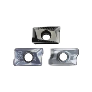

The facemill was delivered by Amazon this afternoon (15 hours after the order was placed). It came well packaged and with an "INSPESTION REPORT" [sic]. Contrary to some Amazon reviews, the insert pockets and general finish look great. I hope to get some shop time to test things soon.View attachment 54437

I bought one of these and sent it back because the Accusize APKT inserts only fit Accusize tools. I already had the “same” tool from Shars and thought the Accusize and Shars (and typical far east) APKT inserts would interchange - no dice so I sent it back.
Accusize was good about it, even sending me a pack of their inserts gratis but I wanted to stock only one format of inserts and I was already invested in the more widely available ones that fit my Shars tool. I bought another Shars tool.
The reason for two tools was I wanted to leave inserts for aluminum on one and steel for the other rather than swapping per job.
FWIW, the Accusize ads showed the more common inserts on their tool but they changed the design and didn’t update the sales images.

The problem is that not all “APKT11T3” inserts are the same. The commonly available inserts you refer to would not fit on the Accusize tool.
The photos showed (still show) the commonly available inserts BUT the inserts that came with it were not the same as in the photo, that’s why it went back. The raised cutting edge/step on the end of insert requires a recess in the tool pocket (for the other end of the insert) and it was not present. The Accusize inserts do not have this raised edge.
Like @Susquatch said, not going to be tied to single sourced, oddball insert$
I notice that in your photo the tool seems to have a pocket for the step so maybe they switched suppliers again….. Do your inserts have the step?

I think they were selling the commonly available config. and changed at some point, maybe they got a better deal from their supplier? If they’ve changed back because of customer feedback (ref. what looks like pockets in @kstrauss ’s photo) then that might be an explanation rather than trying to corner the market for expendables.
While we’re on Accusize, initially I went for them vs Shars for the second tool because of the positive feedback here, shopping in Canada is easier and their reputation of selling good product and good customer service. Through the discussion and return the experience was also positive except the product was not what I was expecting so I would not hesitate to deal with them again.

There are indeed pockets to accommodate the top corner of the insert. However, I'm having trouble understanding your meaning of two types of APKT11t3 inserts. Could you possibly provide a web link or a sketch of the differences? I can take a closer closeup of the Accusize tool if that will help.
Some closer closeups of the pocket and an insert:
@Tecnico - I might have called Accusize and asked them if I could mill out the pocket without getting locked in. I don't think it's critical, just needs to be there to fit the tooth on the insert.
I've never seen an APTK without it. Maybe the smaller ones are like that. I only have the medium sized ones.
Here are mine with a ruler to see scale. These have a squarish pocket, but a round pocket is fine too.

Some closer closeups of the pocket and an insert:View attachment 54482View attachment 54483
I’m not 100% sure but it looks to me that there’s no step on the cutting surface of your Accusize insert. See the photo in @Susquatch ‘s post 15, it shows the step. I think sus’s insert is a larger size but the shape is the same. I have some of those on my larger face mill.
I wonder if the insert with the step would fit your pocket though.

I'm sure some of mine have the round pocket. Similarly, some of my inserts have a slightly different tooth. They all interchange just fine.
Mine don't have an abrupt step but instead a smooth taper from end to end and from edge to edge. I suspect that either shape will fit my pocket.
Not sure if I'm understanding the conversation correctly, but the 2 series are different dimensions so the presumably the pocket must incorporate one or the other.
An APKT 11xx has slightly longer cutting length dimensions than an APKT 10xx (11mm vs 10mm) = item 5 on the cross reference).
And it could also have different thicknesses (item 6 on cross reference).
I'm using APKT16xx & they are readily available
@PeterT We are talking about the fit of two inserts sold under the SAME part number IAW the ISO part number code chart you posted above. That’s what caught me on the Accusize tool I bought and subsequently returned.
Thing is, the geometry, while apparently (claimed) meeting the parameters of the ISO part number varies slightly so one of the geometries does not fit the tool pocket. It’s NOT a discussion of different part numbers fitting the same tool.
It may be the case that the Accusize insert would fit the Shars tool, but the more common insert will not fit the Accusize tool which was a showstopper for me.
