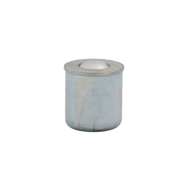

So we all have these "ball oil" spots on our machinery.
What is the proper oiler for them called? I confess I have been using a hypodermic needle to sneak oil past the ball, but I'm sure there must be something that actually is made for these fittings. What do they look like/are they called?

AIUI, you want a pump-style oil can with a nozzle that tapers to just slightly smaller than the diameter of the opening. Press down on the ball to create a seal and then pump in the oil. The pressure of the oil will push the ball down further and allow the oil to flow in.

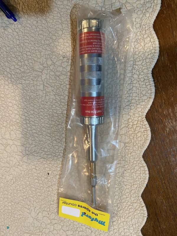

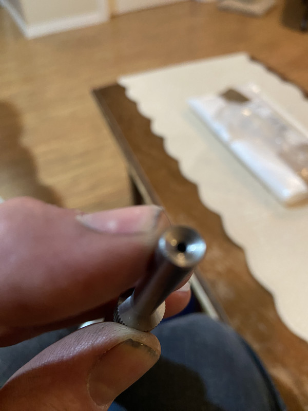

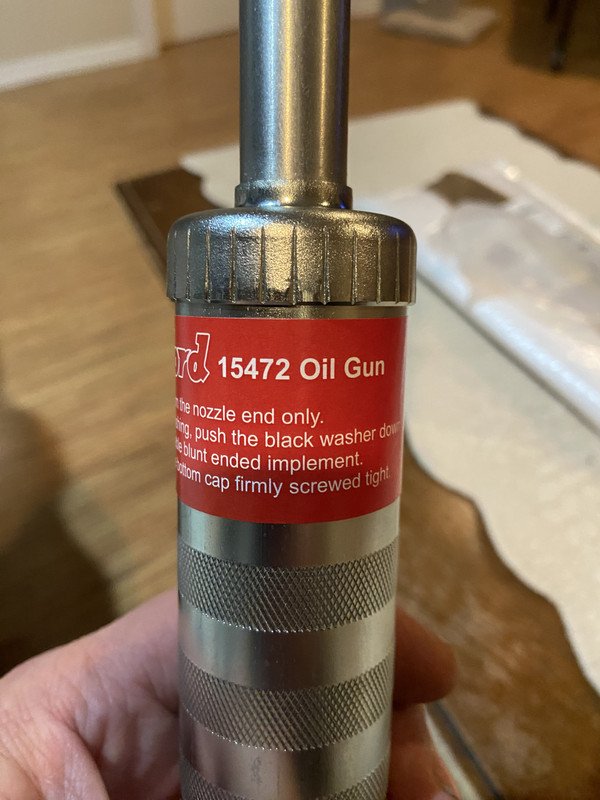

I have a Myford plunger gun like that that came with the lathe that works for all the ball fitting on it. For the zerks on the mill, I bought a grease gun, removed the plunger and so far just use it upside down with waylube. Keep meaning to finish it, and make it water tight, but it sits hanging by a ziptie next to the mill taunting me everytime I use it. When I bought the head off Rauce, when he scrapped his mill, I wish I would have stripped all the one shot system and fittings off it too.....
