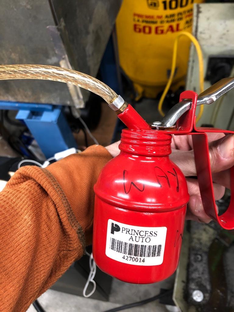

I have a "trigger squeeze" oil can that is kind of a leaking, drooling mess and it just gets worse when I try to force oil into ball oilers on my lathe and I end up with more oil on me and the floor than I do in any ball oiler.
Any one got one they like for this job ?

Been using some of these from princess auto , but I have to look closely as the heads as some are bigger than others

+1 for the PA oiler, that's all I use. Just don't get trigger happy with it.
I have the smaller goldenrod with flexy hose. KBC sells as below, but probably available elsewhere

There was an article in Home Shop Machinist several years ago. I have it but not sure it is legal to take a photo of it and post it. But I can tell you about it. The author milled some custom brass ends for the cans mentioned above but he then cut a groove in them (using an exacto knife) to allow the oil to get by the ball. The ball tends to seal the end of the oil spout and the easiest path is onto the machine instead of into the fitting, I think. A google search showed this article. Combine the o-ring model below with a custom tip and I am sure you will be happy (happier) with what you get.

"Find a pump oiler which has a tapered tip. File or grind the length of the tip such that when you depress the spring loaded ball, the tapered sides of the tip seat against the sides of the hole without bottoming out the ball. Next grind a slot across end of the tip, using a thin file or cutoff wheel with your Dremel tool. Now, when you depress the tip into the oiler, the slot gives a place for the oil to flow around the ball, and the taper seals it, resulting in no mess! "

This is a very common thread. I'm sure I have written into it on both HM and PM. The pump oilers are fine most of the time, but I have a few fittings that actually need a bit of pressure to force the oil in. I always made a mess and was never satisfied that I was doing a good job on the oiling. I converted the tip on one oil can to get a good seal, but I couldn't solve the pressure problem.
I finally broke down and got a Reilang oil gun - fantastic, no leaks, works on both the nipple style and cup style (two end tips are provided). Expensive, but then a tool that works is a good deal (regardless of the cash involved). It works like the push style grease gun (ie. for the roller nose type chainsaw bar) - one could convert a push grease gun. The Reilang is fantastic, one machinist buddy has me bring it over and lube one of his old machines because it clearly delivers the oil, is very quick and not as messy. I got mine from Jens Putzier (ebay).
