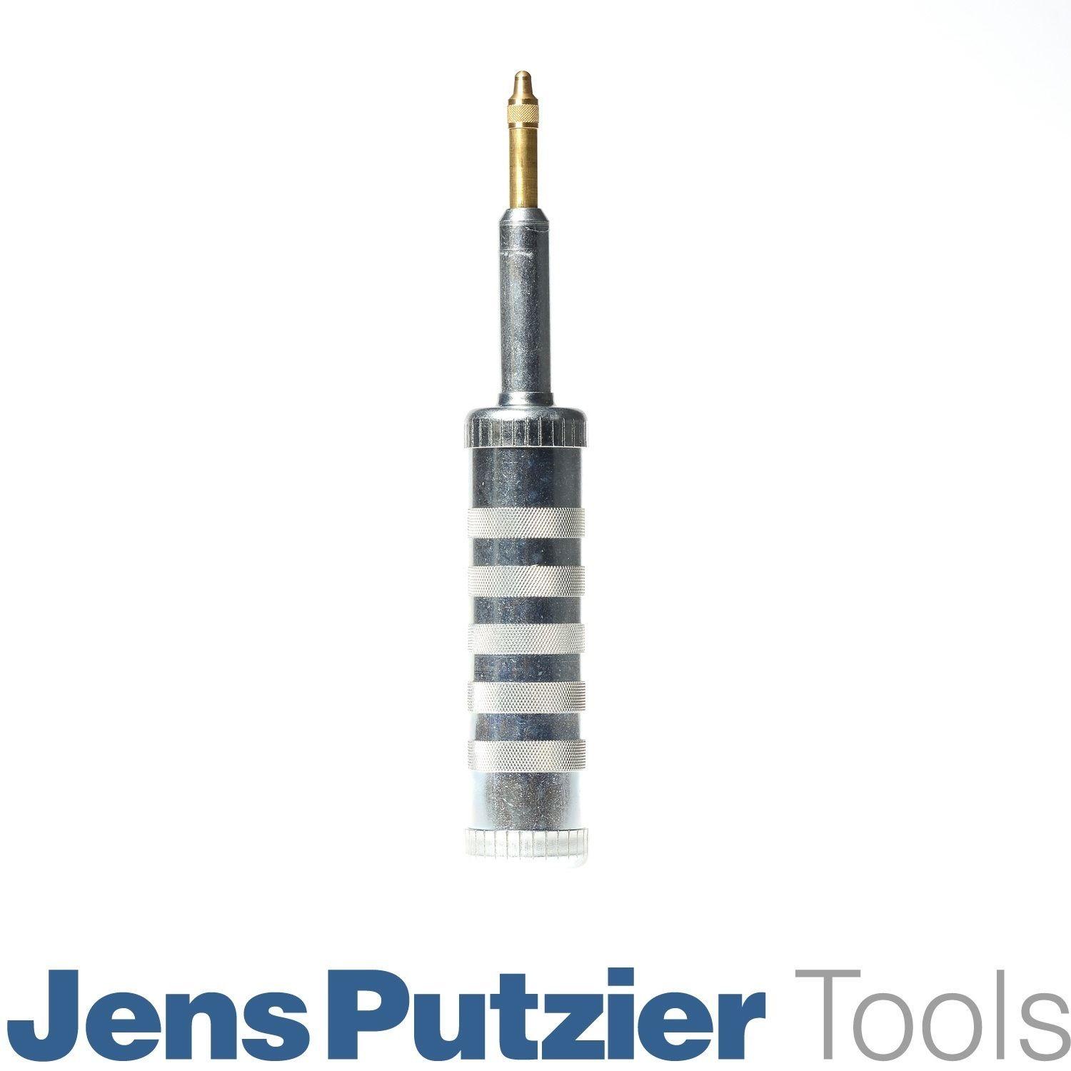

Part number 15472 Oil Gun
Looks suspiciously like my Reiling;
Thanks for all the input! I have some oilers like those that others have mentioned, but I seem to end up with as much oil around the ball as goes down the hole.
I'm thinking of making a tip that has a a rubber collar that I could push down on the fitting so the oil has nowhere to go but down.
That, or a serrated tip so the ball can't form a seal in the opening that forces oil elsewhere.
I modified a regular grease gun and made it into an oiler. If you use a decent quality needle all the oil goes down into the oil fitting.
The Amazon and CT oilers may be the same thing but their part numbers differ:
40469-A for the Amazon one and 26365 for the Canadian Tire one.​
Further to the Myford oiler: yes, mine appears to be well made but it still leaks!
I find the my conical tapered tip works quite well when I am pumping the oil, but has soon the tip is removed I get a pressure build up spill, coming out of the ball and the tip. I have also tried to leave the tip inserted for a longer period of time, hoping the pressure would bleed out but it still make a mess but less.
From the picture, it looks like the tip is concave on the Myford oiling pump, I wonder how well that will seal on the face, but it will push the oil pass the ball without touching it.
I like your rubber collar idea Tom
