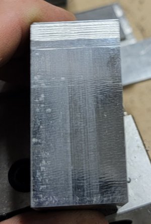

Here you go Brent. 50 thou at 5hz side milling 1 inch thick mild steel was zero problem.
The top of the attached photo was cut at 5 hz on the back gear, the rest was cut at 5hz in direct drive.
No way did that even load the motor let alone stall it. The only difference is the finish - plainly visible in the photo - as my discussion above suggested it probably would be.
Again, it's a cool insight into the material properties and mill function. And it's amazing to watch that end mill peeling off thread after thread of steel at the speed of smell.
The one lonely line just below the back gear cut is when I stopped cutting to get a better continuous grip on the hand wheel.
