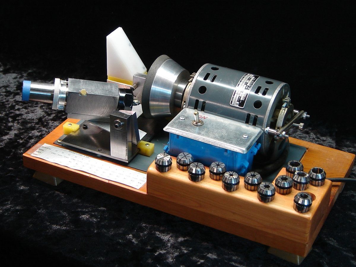

I think I will build one of these when the time allows.
https://gadgetbuilder.com/DrillSharp.html
For drills under 3/4 in I use Darex M1 - original from 1970s. It does excellent job and fast! Main problem is that to split points on it is near impossible automatically.
For drills over 3/4 to about 2" I have build an enlarged version of general drilling attachment. It also does a good job at sharpening drills.
I got rid of DD - it was slow and painful to use. Not even a mile within capability of M1.
I also know how to sharpen by hand. Main reason for sharpening jigs is to get more consistent holes. I.e. get holes within original drill bit tolerance.
The smaller version of general drill bit grinding attachment plus cup wheel is IMHO >> DD. But it cannot split points...

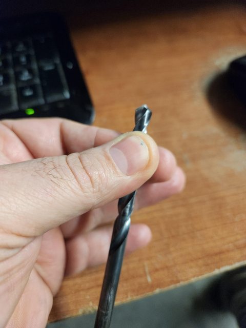

Fingerprints make great sharpening jigs. Press the bit in your hand and grind with your arms tucked into your sides. Then after you sharpen one edge and can index the bit 180* and it will register in your finger print fixture again and you can repeat the process. Keeping your arms tucked in helps make the motions repeatable (like putting). Use you back hand to rotate, and don't move the top one. It doesn't take a lot of pressure, and it really helps to keep the point on center with both lips equal length, and angles.
Drill sharpening by hand takes some practice, like all muscle memory skills, but once you do it's a valuable skill to have and one worth puting the time into.
That being said I would still like to build a nice sharpening fixture someday.
My fingers make marks in the drill bit.

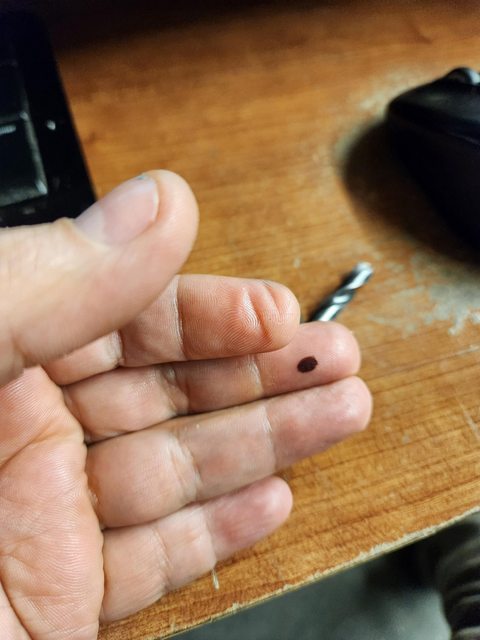

Sounds like Red Skelton pretending to be a chicken...
Truthfully, all I can picture with that description is blood everywhere. Speaking of which, what's that on the end of your nasty finger?
Working hands....blood blister from last weekend. Words were invented. You can just see the tail end of my thumbnail growing out too. As my Daughter used to say when she was little and looking at my hands "daddy, you have too many booboos, you should be more careful".
You're pressing too hard if you're marking the bit.....and if you picture blood everywhere, your supposed to stop pushing when you hit the squishy parts....:D. You, or anyone can do it if you put the time and effort it. Practice makes adequate!
