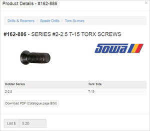

Is there someplace local to source these type of screws? M4x10 My order on amazon apparently ended up somewhere in Italy!? 858BE5FE-EC52-473B-A405-DCB42B04A668.jpeg
John I've found the best source is the suppliers of the tools themselves. It might take some searching but generally they offer them as spares. The Torx + M-thread + head angle makes them a bit obscure for regular metric fastener suppliers even, but I can provide some seller links I've been happy with in that regard. I think a good strategy is when you buy an offshore tool, throw 5 screws on the order (which I am guilty of not doing).
Your original question - going to guess pretty slim pickkins in CowTown. But you never know. You might find a tool supplier like Skinner or DMH (Sowa distributer) but it will proably be a spare to a higher end tool (and more $$). Some of those are interchangeable, some are their own standards go figure.

If @Tom Kitta orders screws by the hundred possibly he has an M4 you can buy? These screws are a bit expensive from sandvik, Kennametal and iscar. I buy them sometimes and they are about $20 each in town.

I was asking about insert screw geometry on HM Forum last night & one of the guys posted this Ebay seller.
The M2.5 screws for CMT & similar (USA made)
https://www.ebay.com/itm/10-Pieces-THFC-006-MS-1153-Insert-Screw/401593009408

I ordered M2.5x6mm. It was about $3 for a pack of 50. I’m sure I could share some.
Thanks John. Where did you end up sourcing if you don't mind me asking?
3$/50 vs $5.20 for one
:/ hmmmm...

Thanks John. I didn't stumble on that particular seller but saw some others (that were a bit more). I think the trick is to search for 'cnc screw' lol
On your seller, I assume this is a typo, but in the order part of ad they say M2.5 x length. Down in the lower part they say M2.6
I think there actually is a M2.6 size but seems like 2.5 is the predominant reference.
