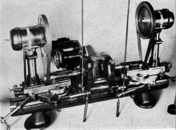

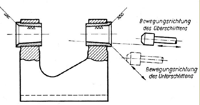

Robin, agreed, they had to be done after pressing in - there was too much eccentricity on the original bearing between ID an OD for it to be otherwise. No matter how accurate the machine, it doesn't explain how to get the taper right (angle is easy....it is getting the diameter dead on (male and female) at the hypothetical plane the tapers meet at that'll make one crazy - there is no good way to directly measure it and it has to be spot on). I think they had to be made on a custom made machine that would get set up with some trial and error and master male and female gauges. Said gauges would be ground almost by fit to each other - thats my theory. All which is way more than you would want to set up for a one of. It is frustrating that once, when everyone needed a watch, 1000's of people would have be very familar with this process with the 100 or more lathe manufacturers in existence. Now it seems we can do little more than guess
There are these images of Boley watchmakers lathe having the bearings done. cylindrical laps at the two taper angles. While still challenging, I can see how a dedicated machine could be construction for production. I still think its incredibly complex to figure out a methodology to accomplish this in a job shop/at home situation. I haven't succeeded at that as my strategy relied on bronze, scraping and lapping. That wouldn't work with the common steel on steel bearing found in 99.9% of watchmakers lathes. You'd have some chance with hard turning on a CNC, but its still not a lapped finish. And you can't lap a taper with two hardened pieces (only worked for me because the soft lapping abrasive didn't affect the shaft)
I will never do one like the above again, too much work for the reward. Its in part to prove I could and in part because there are so many amazing double taper lathes out there (like every watchmakers lathe) I was looking for methodology to fix them (if some knuckle dragger ran them without oil Grrr). None exists, the closest being Archie Perkins (wrote a book on using watchmakers lathes) suggestions which are best "kill or cure" and at worst are rather shade tree
If I was faced with this again, it would plunk down some dough for P4 AC's and big block of durabar and have at it. Probably would use the original shaft and sleeve it.
