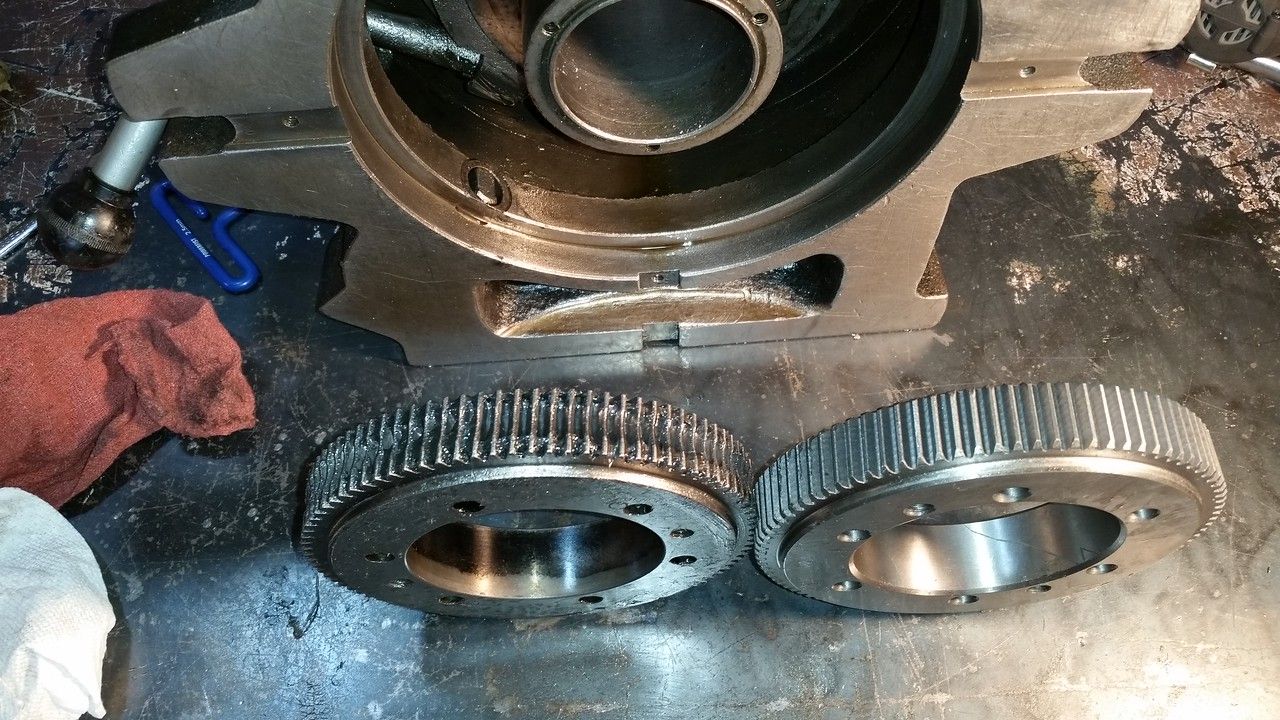

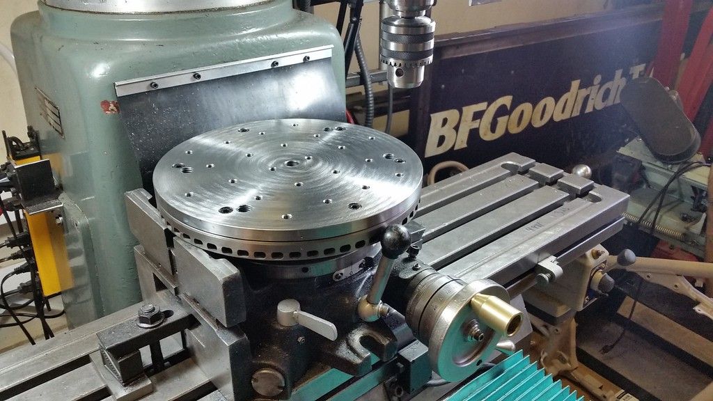

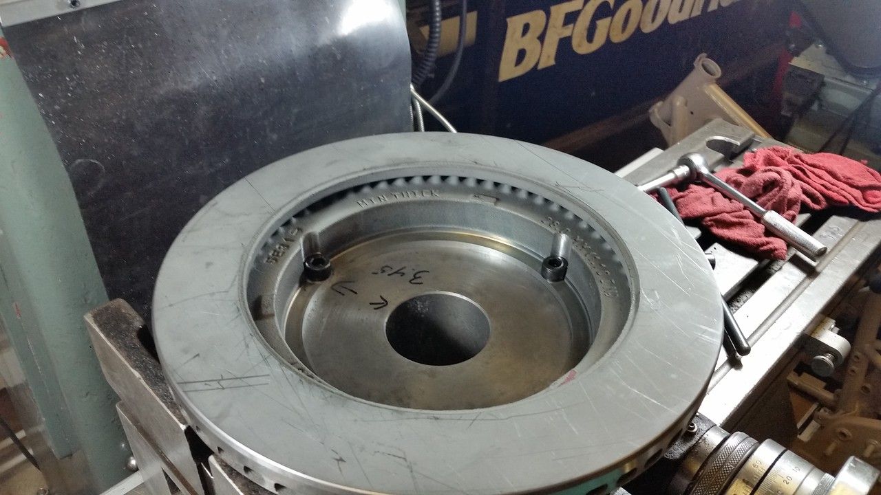

I have a Vertex CS8 Super spacer which is basically a rotary table with a 8" chuck instead of table. I got it used for a good price but it had a worn out gear and it took a while to find a preplacement. I made a 12" table for it using a 12" brake rotor for a GM truck and a 12" round steel plate that I drilled with a pattern of threaded holes for hold downs. With the chuck mounted it weighs 175 LBS so these things are pretty heavy so best to find a way to load it onto the mill table without lifting. It can be mounted vertical or horizontal and I have the indexing plates for it. Used ones are pretty hard to find but if you are patient you'll find one.
As Peter mentioned they do fill the available vertical space between spindle and table pretty fast especially when you add a drill chuck or boring head. That was the main reason I added a 6" riser block to my mill.

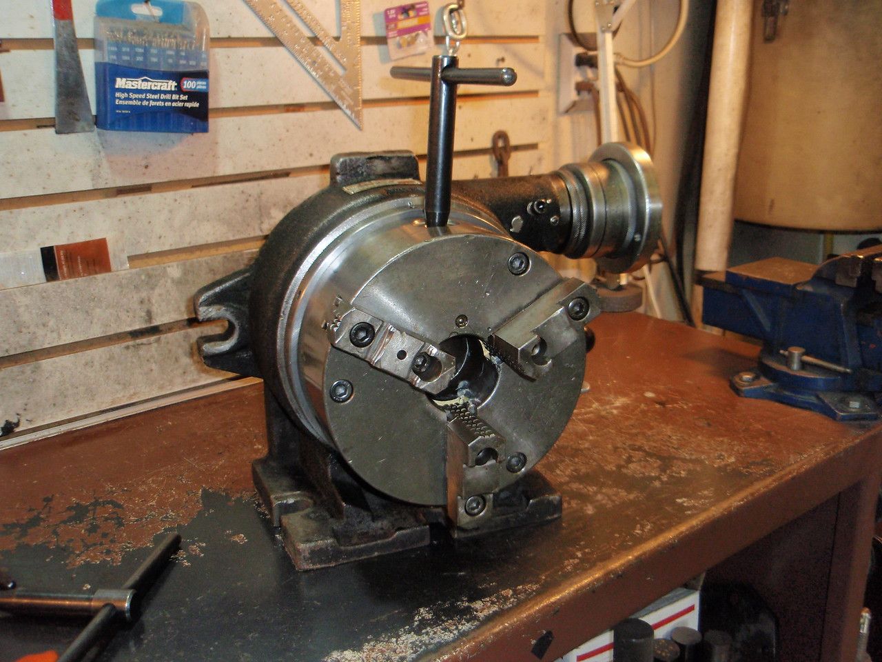

About the dividing heads. I have a few pieces already. See photos below. The easiest one to use is the 5C Collet Head. But the 3 jaw chuck head will do angles off the table and is slick even if it is a bit complicated.
Do they change anything?
@Susquatch : the 5C collet indexer is great for fast machining on dimensional stock. Accurate but not super strong.
the Indexing head with the chuck - beauty! Solid, lots of options and just as fast as the collet indexer once you set things up.
your three jaw (can change out to 4 jaw) size would be my next purchase. I don’t think I would get a 5C indexer as that requires more collets and the fast operations I can handle with a hex/square collet chuck
the big rotary table will allow you to do some pretty cool things the other 2 machines cannot.

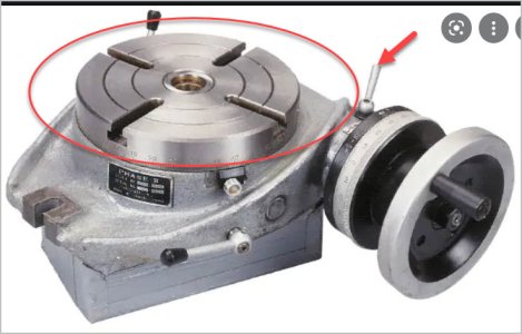

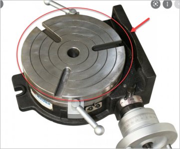

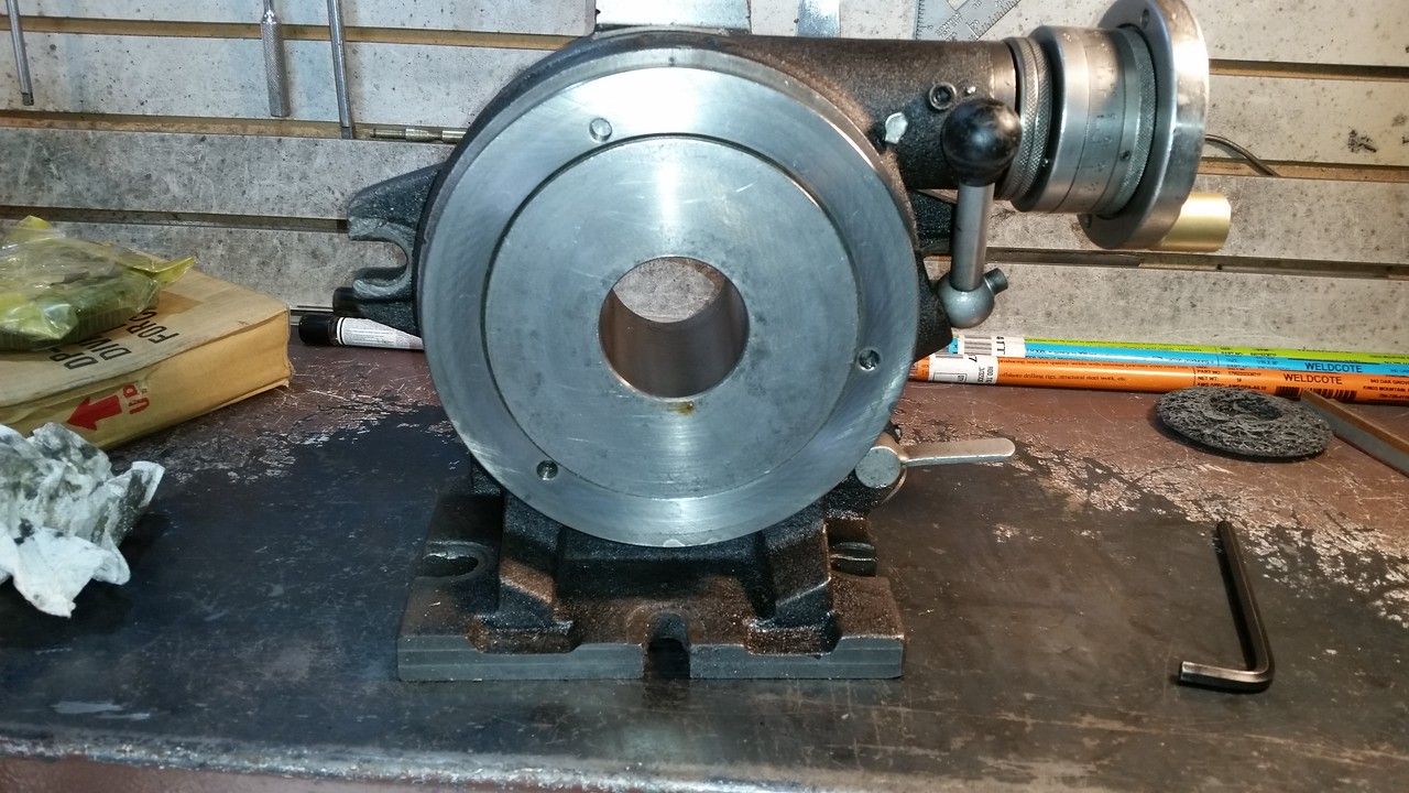

What I was saying about some RT's can accommodate larger diameter tooling plates (or the extending part footprint for that matter) is kind of depicted by these pics. Its hard to judge based on catalog pictures where the dial or casting upright may intercept, but anyways this is what I was driving at.
