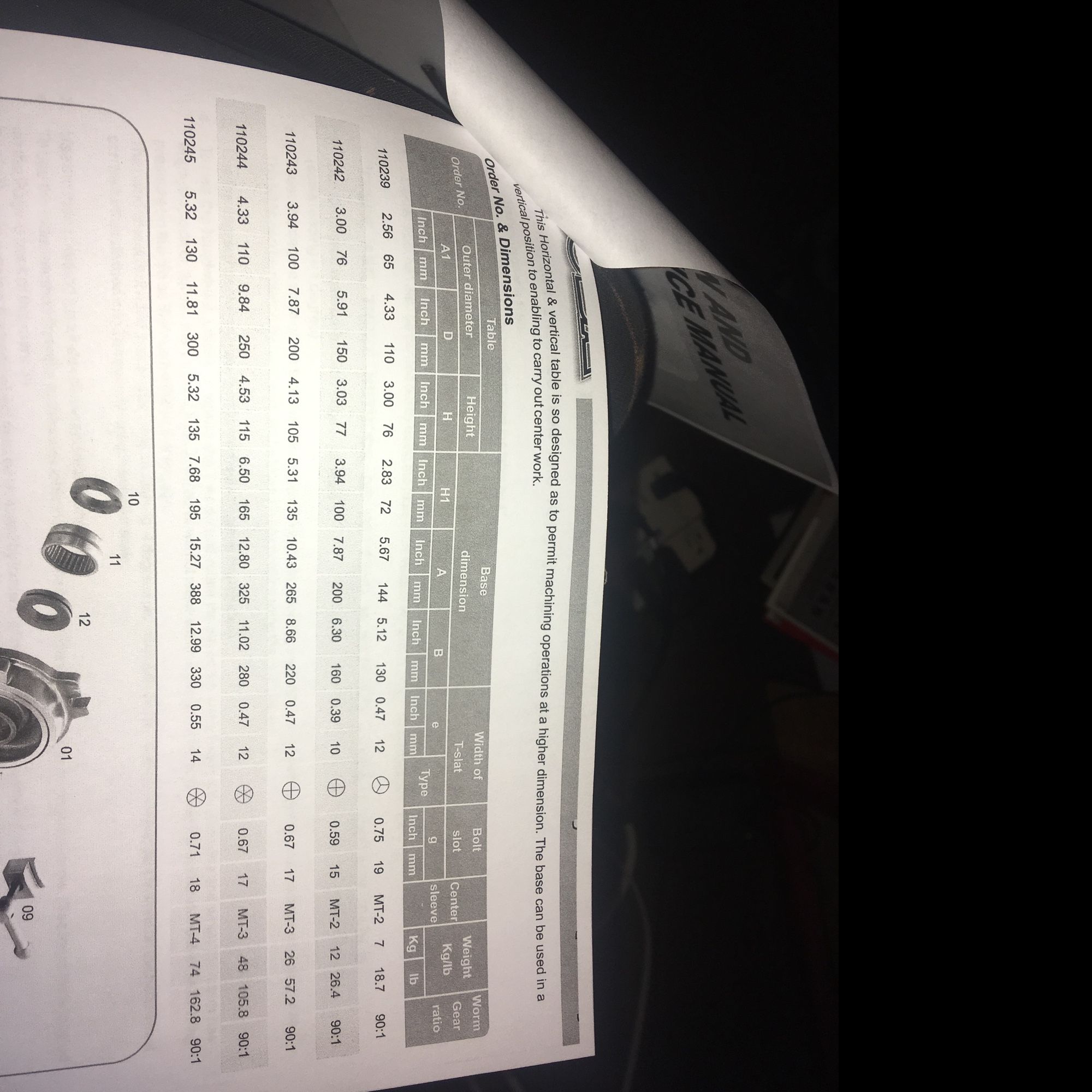

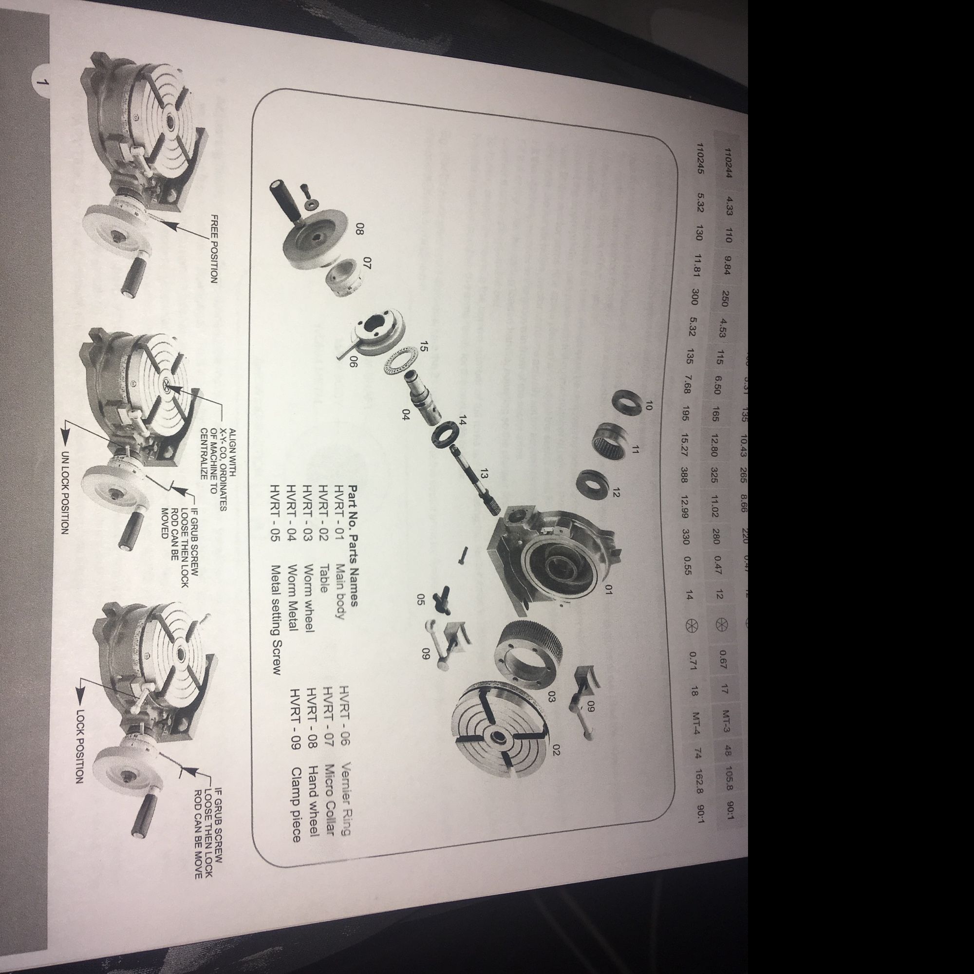

Any one out there have the instruction/user manual for BB 2724 SOBA model 110240 4" RTHV? Mine didn't come with one and I can't find one on the web. I contacted BB to see if they could supply one. If you have one I would appreciate an electronic copy please thank you.
This isn’t the same table but should cover the basics.
Thanks John, but what I'm really looking for is an exploded view and adjustment instructions for the one I have.
This thing has a set screw that I assume is for adjusting backlash, but has no effect unless I loosen 4 crank hold down screws first.
P.S. BB replied no joy on the manual.
Try Grizzly tools and/or little machine shop. Both have a table that looks a lot like yours. I didn’t see any exploded diagrams but I didn’t look very hard.
John
I found several online..... but when I look at them, the part numbers seem to match, but don't. And by match, I have the 6" rotary table (also from BB). In the manual I have, it has the exploded views, and lists models 110239/242/243/244 and 110245, but no 110240. In my manual, 110240 is the optional tail stock
The schematics don't match the one I have either. I'll see if I can post a picture from my phone, stand by.
Hey Kevin
I found your manual online. It doesn't describe my RT. The box for mine states order No. 110240 and tail stock order No. 111302. No. 110240 shows up on the SOBA website as the one I have, but I couldn't find any manuals there either.
