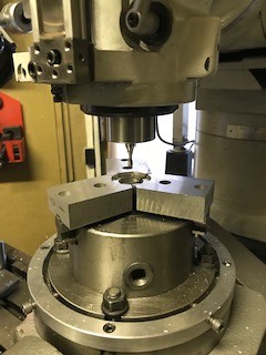

Most 6" rotabs have three slots for reasons such as Susquatch mentions, four slots will be common in 8" and up. I prefer my 8" with the four slots due to the type of work I use it for combined with the specialized fixtures I make to go on it.

Interesting centring fixture!

A very interesting set up @1018Machine. Can we ask what type of work are you doing? Or is it," you can ask, but if I tell you, then--"

As promised, here's my mounting idea! Nothing fancy just some 1018 plain carbon steel machined to fit the application.
In your first photo, it wasn't obvious how you did it, but the photos you just provided show it is very similar to mine.
