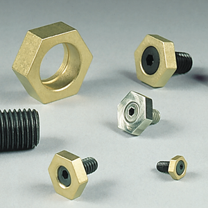

I like how you think. Another accessory if you haven't already made some - a MiteeBite type clone. I replicated the cam screw using a ring pressed on a slightly turned down socket head cap screw. Actually, rather than the MB hex shape, I turned a larger diameter sacrificial disc that I could machine to specific requirements for lathe faceplate work finicky holding, same cam clamp concept.
