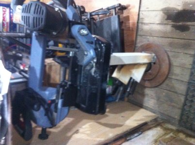

I bought the propoint bandsaw off Kijiji awhile back and the blade busted, I went to KMS and they don't have it even tho there is a spot on the shelf and a mislabeled blade on the shelf, I required a 52-1/2" and one employee said All blades, so a call was made and the next day I picked up my new blades for $22 a piece. Located across the road from ENG AIR and down the road from the sewage treatment plant

They custom make every one in Edmonton and ship it down, guy on the phone asked my needs and recommended a blade based on that need. It's curious that my phone does not display the photos sideways buts it's an IPhone 4 :p

That's the exact saw I have. I bought it a few years ago from PA and now they have discontinued it and the blades which is why I made my own. Its a pretty decent little saw and works a lot better with a quality blade. I am looking to add some mods to the vise to make it closer to the blade for better support of short pieces.
My solution approach to that was make it convert to a vertical. And I was happy to find I only needed to make a cut table to make it work.
