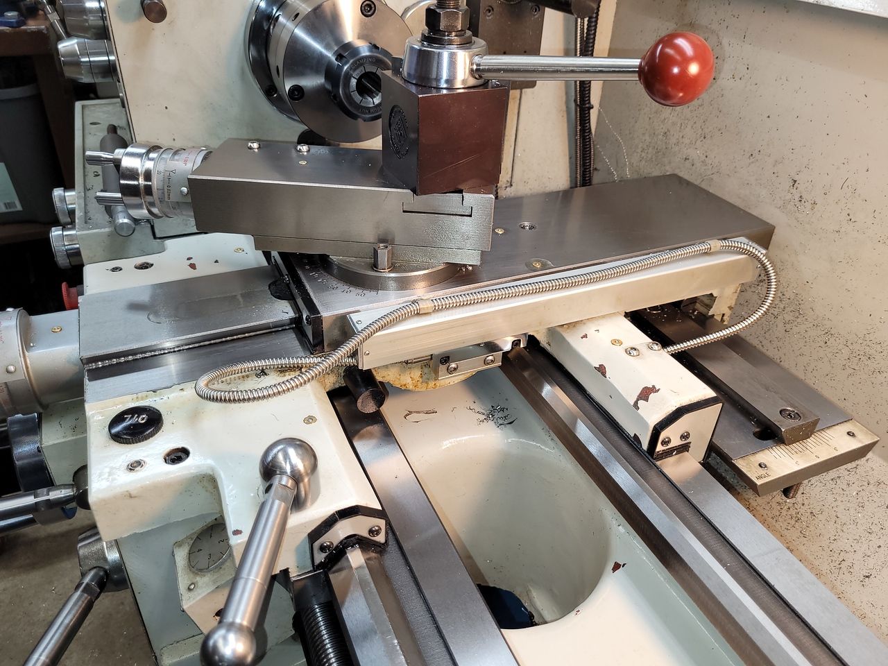

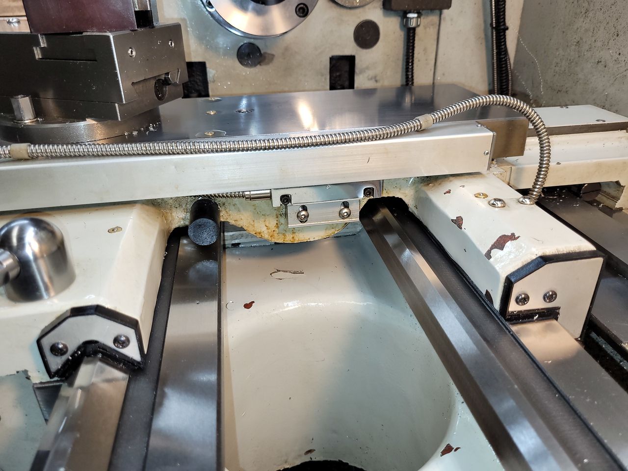

In your last picture I see the cable running up on top, is that for the reader head on that scale? I'm thinking I'm going to mount the reader head down below the scale and run the cable out back.
My scales have a backing plate that mounts to the lathe, then the scale gets screwed to the backing plate.

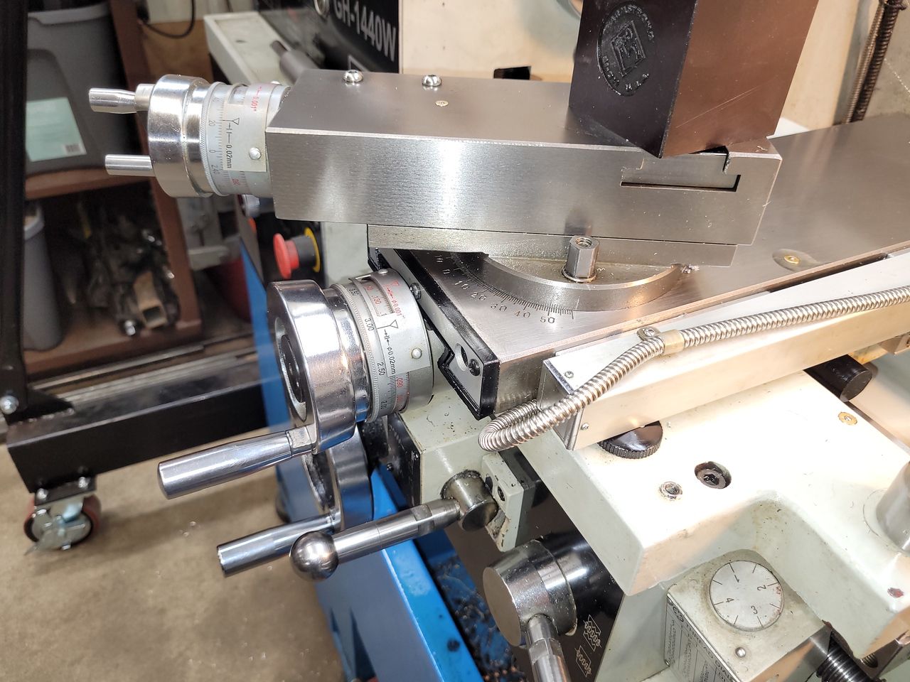

The DRO was mounted at the factory and initially I thought I would change the cable routing so it went straight out the back but it turned out that the way they did it was the best option. The cross slide casting it taller over the rear bedway rail for some reason and would not allow the cable to pass underneath the scale and still keep the top of the scale below the top of the cross slide. This arrangement also keeps the movement of the cable during cross slide travel manageable as these 2 pics show with the cross slide at the end of travel in both directions.
I'm hoping that the future will bring slim scales that communicate with the DRO head wirelessly but for now this is my best option.
What would it matter if the scale is below the cross slide if the cable ends up not being below?
In my planned installation my scale and guard will be a bit higher than the top slide but still allow the compound to swivel. That should not be a problem for anything I can think of?
The way I'm doing it is the reader head is being mounted on the saddle between the ways and remains stationary and the scale is what travels along with the slide so gets mounted to it.
Can you not do that with the reader and scale mounted on the front of the saddle?
I just wanted to keep it mounted the way they did it so I didn't need to drill any more holes.
It wouldn't matter if it was higher as long as you can still turn the compound
Maybe we are using different terms. The photo shows what I'm referring to as the saddle.
If both reader and scale are mounted to saddle then nuttin' is moving! (Well not independently of each other)
