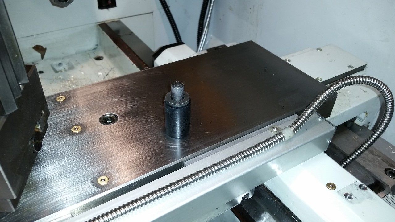

I'm going to be installing a DRO on a lathecross slide but the way I think the scale should be mounted blocks an oiler port. Drilling a new hole in the saddle and popping in a new oiler port in a different location shouldn't be a big deal right? I'll just plug the old hole. 20221104_062541.jpg
DPittman
In my experience with oil holes they are sometimes located to feed into a channel or line that takes oil to where it is required. I would take it apart and see how it is constructed.
Yes I forgot to mention that there is likely a channel on the underneath that I could just drill up from the bottom to make sure I get in it. I've had it all apart but I just don't remember exactly what it looked like underneath there.

I cannot tell from the picture, does the scale sit right on top of the carriage and cover the oiler? If there is room between the scale and the compound could a oil line be inserted into the oiler hole?
It might be easier to just buy a slimmer scale and sell or re-purpose the other one.

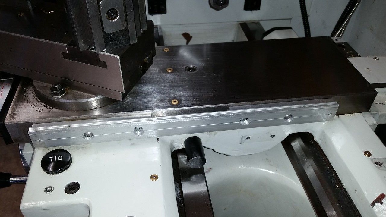

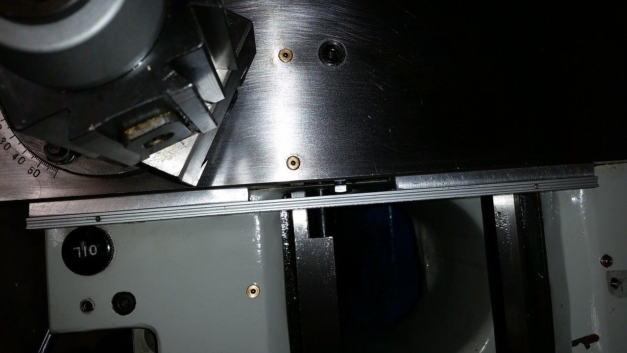

The slim scale solution would definitely easily solve the oiler port problem but I think I'm going to be okay afterall but it will be close. I also have to mount the scale away from the cross slide surface to allow access to the slide lock. :confused:Traveling rest mount on the carriage keeps me from installing the scale on the opposite side (plus I don't want scale under the chuck).
My next obstacle is mounting the scale brackets into the slide surface as their is very little meat to drill and tap into as the gib adjustment runs along that side. See pic. 20221104_065349~2.jpg
So now I'm wondering if JB welding mounts to the slide surface is likely to be satisfactory?

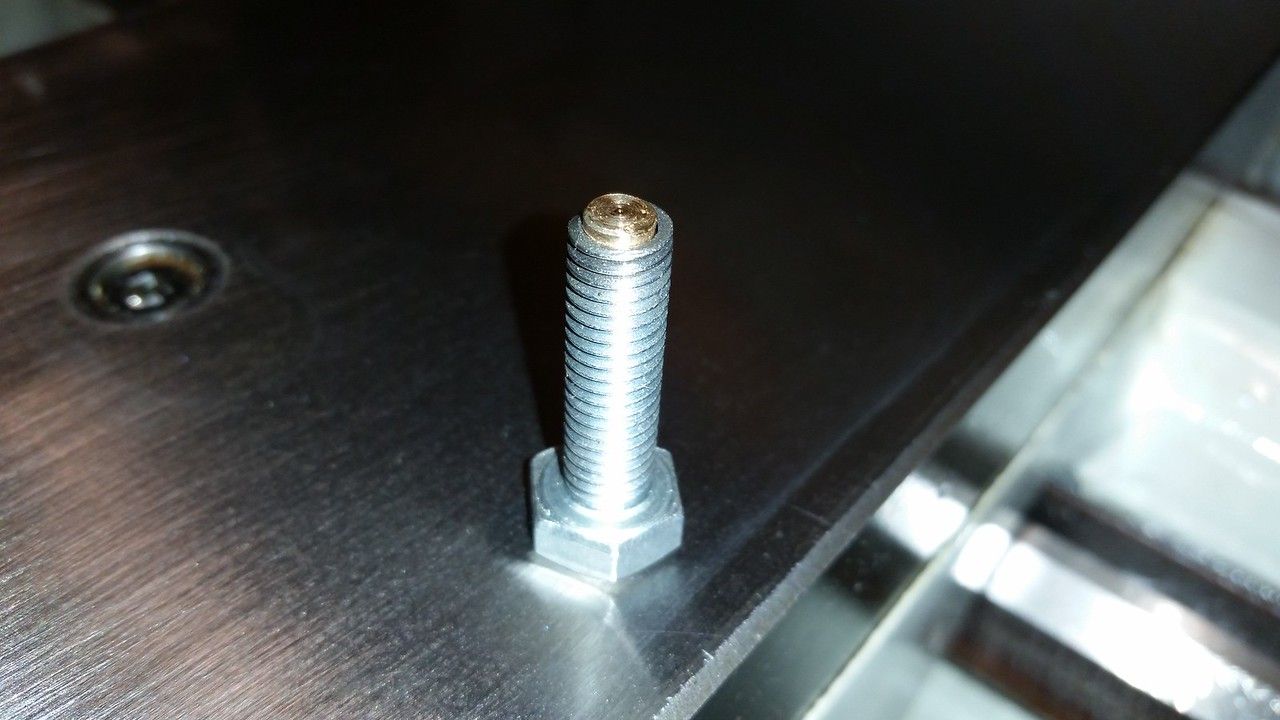

Drilling a new oiler hole should be no issue but assembly will have to be removed so you don't over drill into the bed. When see the underside you can verify channel or no channel in which case yes you should connect it. But it its like my Taiwan 14x40 lathe, those ports just dead end to bed way. Which is why there is so much back pressure on an oiler using higher viscosity way oil & it makes a localized puddle instead of nice distribution.
Oilers vary in quality so I would have those in hand beforehand. What they call a 6mm body may correspond to a slightly different drill to make it press in properly. If its loose that's no good, it will probably hydraulically lift with pressure. Ie. so try it on a practice chunk of steel before your lathe. I had a lead on the higher quality 'red dot' euro ones Stefan used but they were PITA to order. i should have perservered, this topic has come up so many times.

It looks like your gib strip is right at the bottom surface of the cross slide. If you remove that gib adjusting screw you'll see how tall it is and drill your screw holes above it. I agree with the others, I would remove the cross slide to drill the new oiler hole. You really don't need to make a plug for the old one, just leave it where it is. I made 3/8" thick spacers to move the cross slide scale outward so I could access the lock screw with an open end wrench. I added a brass insert to the end of the screw and made it just long enough to lock the cross slide when fully threaded in.

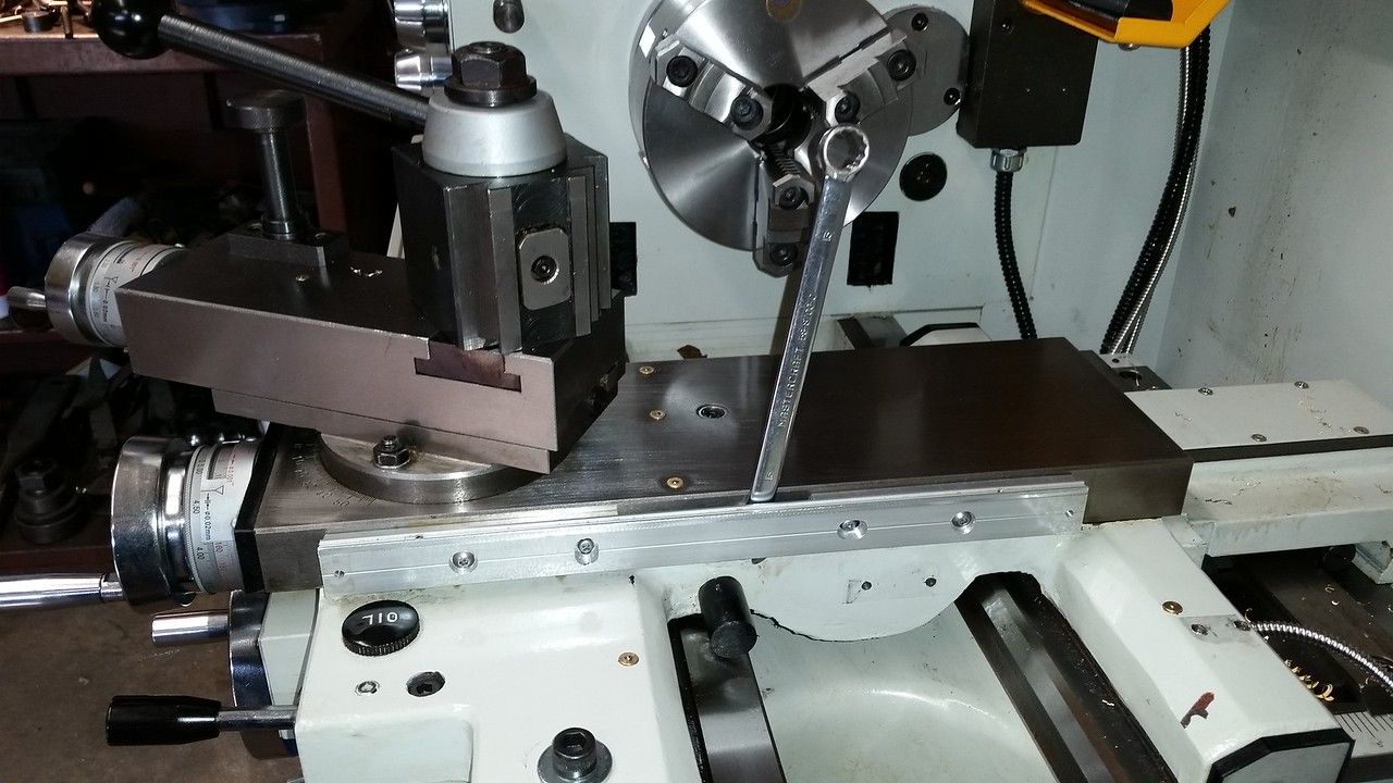

Do you have a table lock on the RHS that the scale will cover up for example?
Yes I have a table lock on the rhs, but I should be able to get the scale in just before the two obstacles. But i wont be able to have the cover over the scale. And no I don't want to loose the ability to use a steady rest 20221104_133546.jpg on the front side. At least that's my latest thinking. See pic.

Yes that is pretty much what I was thinking also in regards to accessing the table lock also.
In your last picture I see the cable running up on top, is that for the reader head on that scale? I'm thinking I'm going to mount the reader head down below the scale and run the cable out back.

With 3/8" clearance away from the slide for acces to slide lock it looks like the scale will just clear the carriage lock. The oiler ports might also be useable like that but just barely. I think relocating the oiler ports will likely be easy enough and worthwhile. 20221104_151217.jpg
