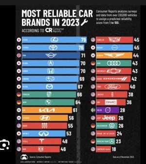

Every time I start looking around for another new (used) car, I'm tempted by the German brands, they have so much going for them; style, braking, handling, technology, then I look at the reliability ratings and just cringe. Mercedes second from last of 30 brands for reliability "Really". Porsche seems to be the exception but pretty pricey. In the end I always revert back to another Toyota and every one of them have been marvels of reliability, eight so far in the family starting with my 73 Corolla that I purchased around about 1980.
I see Mini has really moved up, they use to be at the bottom.
I was part of a focus group 25 years ago or so. What I learned then was that those ratings are so biased that they are basically unusable.
Two examples to illustrate.
First was a pair of models made in the same assembly plant, with the same parts, the same labour, and the same body and suspension. Even the same paint! The only difference was the model and make. One sold in European dealerships as a Japanese brand, and the other sold in North American dealerships as a domestic brand. The warranty and problems on the domestic brand were almost 7x as bad. Even the paint was 7x as bad. How the hell was that possible? We did a really deep dive extracting thousands of repairs and talking to every dealer and every customer. What we found was the expectations were different. Customers buying the domestic car assumed they were crap and demanded repairs. Customers buying the Japanese product assumed that they were as good as they got and no point in repairs.
Another example, this time just looking at price class. Similar story. People buying expensive cars (Mercedes, BMW) were picky picky picky. People buying less costly vehicles of the same brand were not so picky. The replacements on the luxury models for the exact same part numbers were double the same part on the less expensive model. Why? Again expectations drive the survey results.
Bottom line, throw those fancy magazine quality ratings in the garbage. If you need to look at them, consider the customer base before thinking they are meaningful.

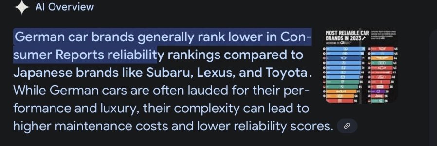

Just my personal opinion but I find the JD Power ratings super biased and near useless. I have found CR ratings based on feedback from over 300,000 responses per year from actual consumers about as good a metric that is available. One simple example my daughter drove her 12 year old 2005 Corolla from 2017 until now and it required one $30 part. During that same period her best friend went through two Audis with 1/3 the milage that were < 10 years old and spent probably $10k in repairs during the same period.
Seems pretty consistent with the CR ratings.
Well, I'm here to disagree.
That's anecdotal. Both are based on consumer feedback, and both useless because they are heavily biased by expectations.
Now if you put 10 machinists into 10 different vehicles blindfolded and asked them to rate something, you might get a pretty good result. Make that engineers and the odds of a good result goes down cuz they would figure out what car they were in. LOL!
