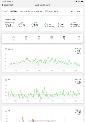

Below are our radon levels for the last year. If I recall correctly before I installed a fan our levels were over 300 based on a certified 3 month test.
Two things I don’t like about the AirThings Wave is that:
- It detects when I’ve used VOC’s in the workshop…
- There isn’t a mode to hide certain data from my wife…
I have to remember to run the HRV continuously before I start playing with VOC’s…
(The red you can just see below for CO2 is when the smoke was bad in Winnipeg last year)

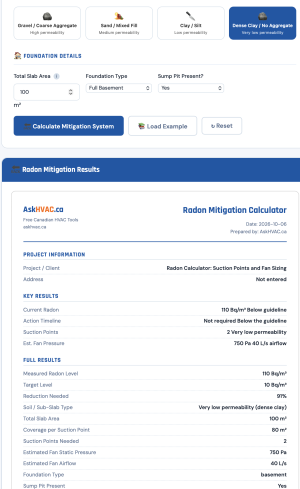

Back to this.... My long term radon average is 110Bq/m3. So I'm going to do something about it after kicking it down the road for too long. I have a bucket sump pump in the floor and I intend to connect a fan and vent out the side of the house. Likely a 3d printed flange, and some abs pipe?. While trying to figure out what I need to buy I came across this calculator https://askhvac.ca/air-quality/radon-mitigation-calculator.html which suggests the fan strength and the number of extraction points required for your specific situation.
