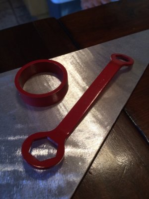

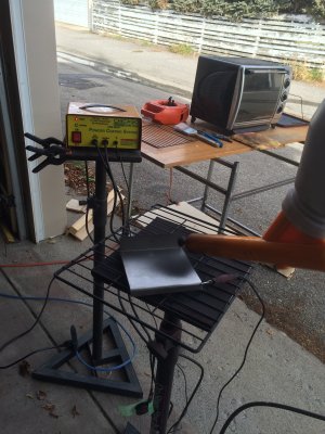

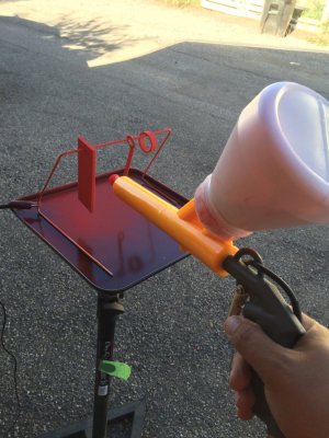

On my last visit to the states I picked up a powder coating gun and some powder on sale from Harborfreight. I also found a counter top pizza oven at a garage sale for parts baking. Here are some photos of it in action. It's much easier than anodising. The sample parts are a galvanized wrench and a piece of 6061 Al tubing.
Edit: added photo of the transformer which puts a negative charge on the part and a positive charge on the powder as it is blown out of the gun. You can see the alligator clip wire attached to the part on the stand. The gun has another wire to the cathode in the gun tip.

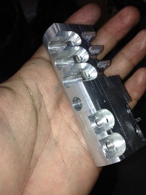

The part I am working on is a muzzle brake for my hunting rifle:
(For anyone who doesn't know, Muzzle brakes go here on a rifle: http://screencast.com/t/kIL6wJgFyJc3
--> Exposure to hot gasses.)
I imagine the powder coat would be fine, but am not 100% sure. Any thoughts?

The powder gun was $100usd including some colours. I really don't know what coating technique would be better for durability. I would think either would work well, much better than paint. The results are my first attempt!
That is some cool machining. Your own design?
But - I do Josh have safety concerns - if anything goes wrong could that part become shrapnel? Is Al the right material? What kind of over pressures might be produced? If it works fine but if it fails what are the consequences to you or others? Sorry to be a downer - I'd rather see you buy this particular item from a respected manufacturer. I'd be happy to help you finish the part with a coating if you can agree it's only to be an exercise and not used on your rifle. I simply can't gauge if this kind of part is reasonable or not - and I'd rather be safe.
That does bring up another topic - general safety of things we make for ourselves or for others. Nobody here has insurance if stuff we do fails in use. I don't weld trailer structural members for example. Some guy I know wanted me to machine up some engine mounts. No. I don't want to be liable or responsible for an injury or death. Never mind the financial legal horror that could ensue- I simply couldn't live with myself.

With regard to the machining, thanks! I have sunk a handful of hours into this little guy. Learned alot as always.
This is based off of a design that is not mine originally, but I did modify the original design to reduce amount of stress put on the brake, as well as increased the sidewall thicknesses.
With regard to usage and safety, I would be lying to you if I told you I wasn't planning on using this on my rifle, but I want to assure you that the risks involved with this particular project are well known.
The involved risk is no greater than usual when out shooting at the range.
It's pretty safe as long as you follow standard gun safety rules, but I totally understand and will not push if you choose not to help in this case, all good!

I feel I should put in my $0.02, as I've been a range officer for over a decade and a shooter for longer (target only)...
Anything that has a possibility of getting in the way of the round should be avoided, so powdercoating, while typically more durable to physical damage, may not the best choice. The thickness of each coat is an art more than a science, and if the exhaust gasses get the attachment close to or past the curing temperature, I believe it will possibly run or sag. Physical damage to the coating may also peel some of it off along the bullet path, which could cause deflection in the least case and shrapnel in the worst case. If you leave more clearance along the bullet path, it becomes less efficient in redirecting gasses to reduce recoil (or flash, if you're worried about that), but would be more forgiving with the coating tolerances.
I'm not sure how anodizing stands up to heat, but as it's a chemical/ionic process instead of the electrostatic process of powder coating, it should wear off, as opposed to possibly chipping off. The only question there is heat and physical durability. I know dyes for anodizing metals will scratch off relatively easily, while the oxide forming the anodized layer should still provide corrosion protection... not that corrosion will typically be an issue with aluminum.
A third option for coating/protection is blueing or parkerization. These (I believe) will only work on steel, so you'd have to do a prototype for fitment with the aluminum, then duplicate it in steel for coating. These two processes are standards for firearms, and while they aren't identical, they're more or less the same results. At the end of it, the part will have that "firearm color" that is ever so slightly blue and takes forever to wear off. And therefore is also highly temperature resistant.
As long as the metal of the brake is less hard and/or tough than the barrel (which is almost 100% the case) then the threads or material of the brake should fail before causing issues to the firearm itself. Are you using an existing thread on the barrel to mount the brake, or are you manufacturing some sort of clamp? Obviously a thread would be far more likely to be fully in line, but most civilian firearms (especially in Canada) don't have threads for barrel attachments... something about most attachments being highly illegal... Clamps would then work, but being in perfect alignment is then an issue.

I wouldn't powder coat, but not for safety reasons. Just because it's going to wear off easily I think.
If you got paint in the way, the first bullet would instantly deflect slightly and clear the path perfectly.
A good way to powder coat it would be to put a rod down the bore of the brake, then you know your bore dimension won't change. But realistically, the first shot would clear it out.
The real danger with things being lodged in the bore comes from overpressure. So you'd want to make sure there's no paint in the area before the first ports, but once the bullet has cleared those, the pressure can no longer build up.
Anodizing would likely be a better bet though anyways. Not for safety reasons though.
And if Josh is following normal everyday range safety rules, there's no danger to anyone. If the brake blew up (almost impossible with an ounce of care and attention when making it), it would almost solely fly forward and outward, it wouldn't come back. There just isn't enough room for the bullet to get that sideways.
Hi Janger,
Can you run through what steps you have to take to powder coat something? I thought there was current involved some where in the process to make the powder coat adhere to the metal?
Wayne?
Janger
(John)
Hi Wayne
Welcome to the forum!
I added another photo and a bit more description to the original post. Ask away if it's not clear.
John
Wayne
Member
Hi John,
Okay, I'm a little slow on this, are you running a current through the stuff your painting while your painting it or after? Or at all? I always spray paint my stuff but would LOVE to learn how to powder coat.
Janger
(John)
Oh yeah the operation didn't mention that. There's a foot pedal, press it and it charges the part and then while pushing the pedal press the trigger and the compressed air (yes u need a compressor too) blows the powder out of the reservoir and out the gun. It's a lot like spray painting. The powder sort of curves through the air and gloms on to the part. The powder is a lot like photocopier toner and just as messy. The powder then clings to the part. Carefully unhook the wire, and gently put it in the oven at 400F for 15-25 minutes. The powder melts and adheres just with the cooking.
It's pretty easy to do. The problem is many parts don't fit in the oven. If you have space buy an old crappy oven.
If you go find my thread on curtain stands you can see the results.
Wayne
Member
Thanks for the info,
Can you use a microwave or do you need an actual oven? I think a stove oven would hold most of the stuff I would be powder coating. I really like the finish that powder coating give you. I want one!!! LOL.
Wayne
Member
Sorry to keep asking silly questions but...The alligator clip when attached is not going to let the paint pass. Does it leave a unpainted spot where the clip was or is there a way to prevent that?
