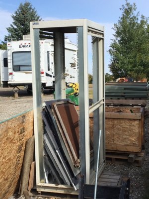

I've researched making my own oven and have accumulated some old IT server racks that should allow for motorcycle frames ...... but have not progressed further as this will consume some quality space in the shop

Various pieces of sheet metal (look inside the rack). I pickup old washer dryers and salvage the shells which i use for projects like this. Makes good use of air riveter
I'll use standard insulation (roxul safe and sound) as this only needs ~450 F
Pid controller with one or two oven elements , maybe a circulating fan and bobs your uncle
Just watch the odors coming off the stuff...I know a lot of guys that made smokers out of old file cabinets, but some had lead paint.
Would there be a big temperature difference between top and bottom hence the fan? Pid temperature control? What is that? Great idea.
