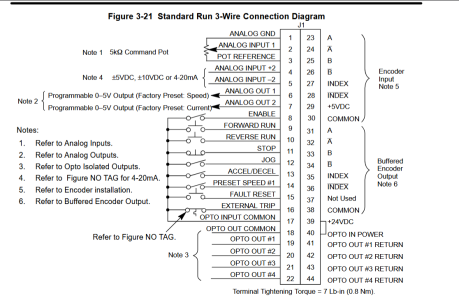

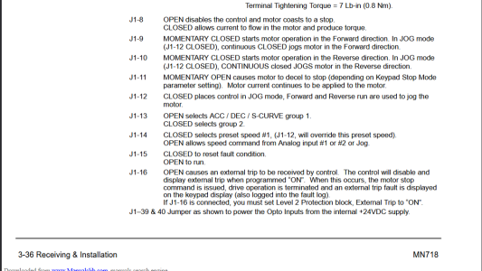

Right. I forgot it said momentary switches. I may have momentary switches now because there is at least one contactor in the existing electrical box now.
My pdf is truncated. I'll have to try it again.
I confess that I find it hard to believe that the fwd/rev switches are momentary. If that's the norm, I'm not aware of it.
Or is that perhaps an optional configuration?
The VFD can also have the two momentary switches act as JOG buttons. While held down the motor turns.

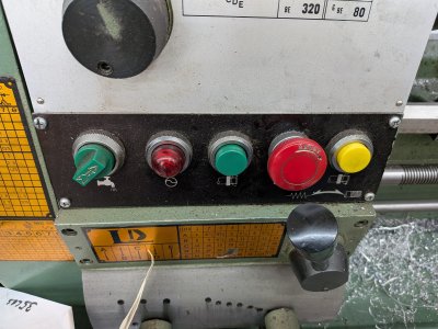

My needs are:
A start/stop switch
Forward switch
Reverse switch
Jog is entirely optional.
This is what I have now.
Left is for coolant pump which I don't have.
Indicator light
Reverse rotation
Stop switch
Forward rotation
Oh that's the start/stop to me.

I've downloaded the manual twice now. It seems to be incomplete. I cannot find page 3-47. In fact the last half of section 3 is missing for me.
I REALLY want to see how this momentary switch stuff works.

Picked up the switches today. All I need to do now is move a dozen things so I can get to the hoist so I can move the lathe away from the wall.
