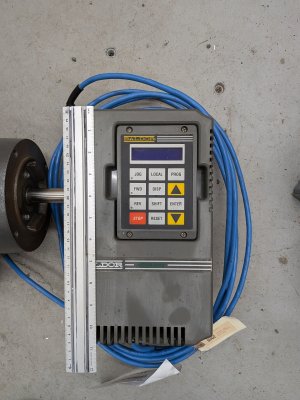

Possible candidate for 3-phase for my lathe?
Picking up the motor on Friday
The motor I got for my mill is zero rated too. It's amazing!
Even if all you ever do is look at it......

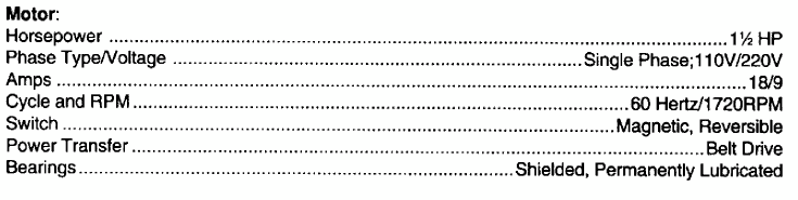

Oh maybe I'm wrong about the motor....maybe it's not 1.5hp. In fact I'm not sure where I got that figure. <shrug/>
Edit I got it from the Grizzly manual for their version of the BB 1237G lathe. Is mine actually 1.5 hp. I have no idea TBH. I guess I'll find out when I pull it away from the wall to install the Z axis DRO and do the motor swap.
I wouldn't put that particular motor on your lathe anyway. It would be a waste. Better to get the right 3ph motor (w 20% more HP than stock) and a good VFD for your lathe and save that crown jewel for the right application - or sell it to me.......

This is the manual for the VFD.
Looking at the Fig. 3-21 on pg. 47 of the pdf I believe a 5K pot across terminals J-1, 2 and 3 will give me speed control and a SPDT switch between J 8, 9 and 10 will give me fwd/off/rev.
If someone could check my thinking I'd be grateful.
I tried checking for you David, but the PDF is incomplete on my end. I wanted to read pg 3-47 regarding analog inputs and couldn't find it.
In general that's how my Teco works.
Thinking for connections looks okay.

The notes say momentary for the forward reverse and a separate NC button for stop.
so you have a momentary button you press to make it go forward and then a NC momentary that you press to stop the motor.
These are NO
Or go this way momentary in either direction for forward/reverse
This one for the stop switch since it has NC contacts.
Put this one on Terminal 8 for the ENABLE.
You could also have that one instead control a contactor with an extra pole that does the enable.
Thanks gents. Now that I think about it I 'd like to reuse the two switches on the lathe.
Right. I forgot it said momentary switches. I may have momentary switches now because there is at least one contactor in the existing electrical box now.
