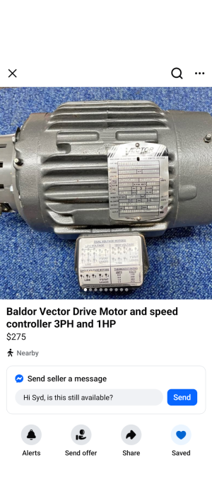

Possible candidate for 3-phase for my lathe?
David
Scrap maker
Says 1hp. Currently have 1.5hp single phase.
Is this worth considering?
I would probably hold out for a 1.5HP but it depends.
With a good VFD it will make good torque at low RPM, so it depends on the gearing, if it was marginal with the original 1.5HP you might want to be patient.
Not a bad deal for a 1hp motor and VFD. Buy it if you've got the cash, and a project in mind for it, but I wouldn't buy it to swap for a lathe with a 1.5 hp currently. Might be nice on a drill press or something though. Or build another grinder.....
I would love something like that for my Myford eventually.
That's expensive for a used 1HP 3PH.
Call Bob's Motor Electric and see what price he'd do for you new in 1.5HP. It's not 2x that price, almost certainly.
Ya, buy the motor for another project.
As @thestelster says, that motor is VFD rated. Setting aside that amazing top speed, it probably has a very low bottom speed too - maybe even zero rpm at full torque.
Ya, buy it.
