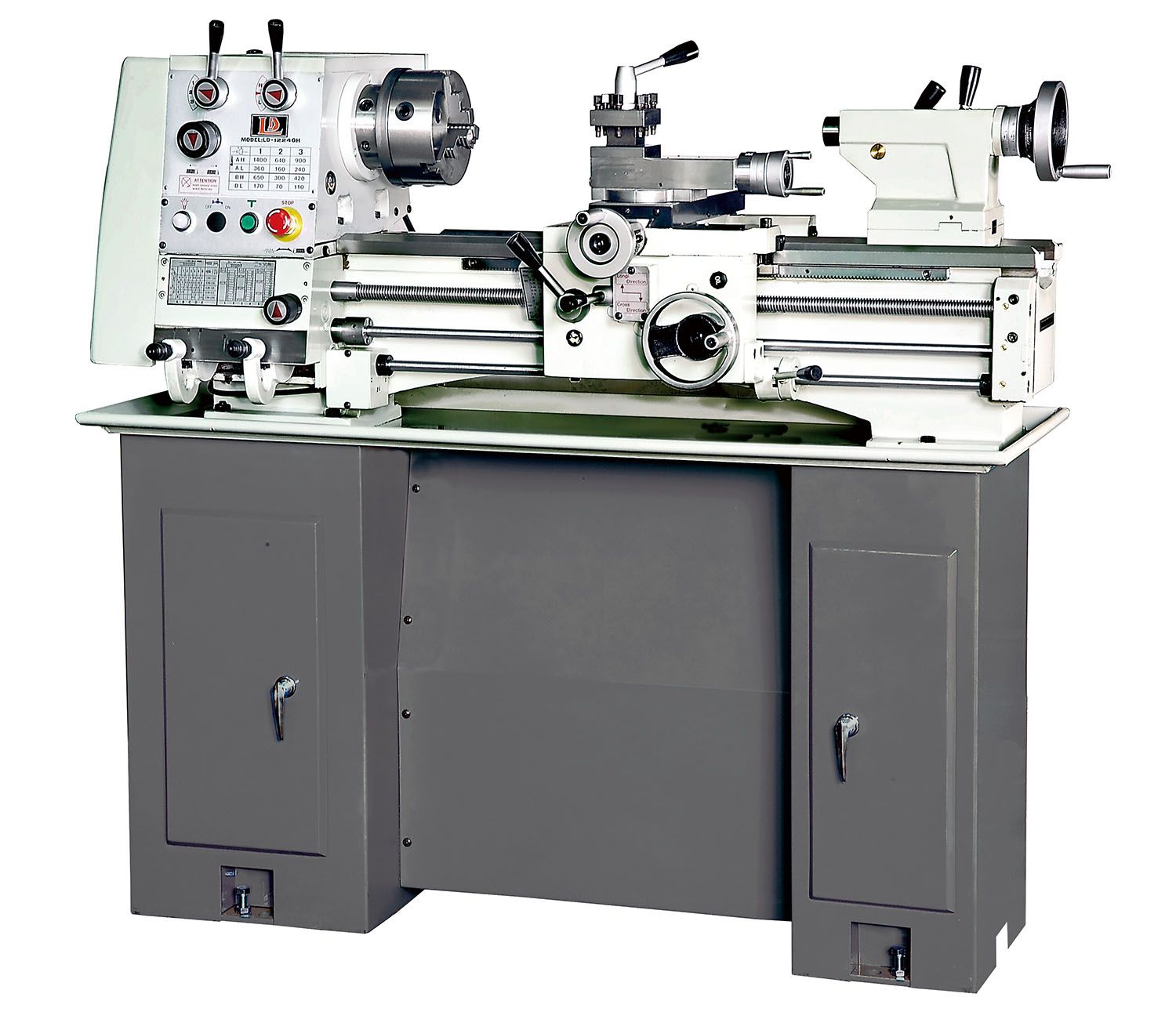

I wanted to buy a 12x16" metal lathe but no company is importing them into Canada. They're quite common is australia and new zealand though.
Taiwanese company Model : LD-1216GH Liang Dei sells them. Perhaps give them a try if you can wait for the shipping
@TorontoBuilder Those look like very nice machines. Any idea what the price range is landed?
