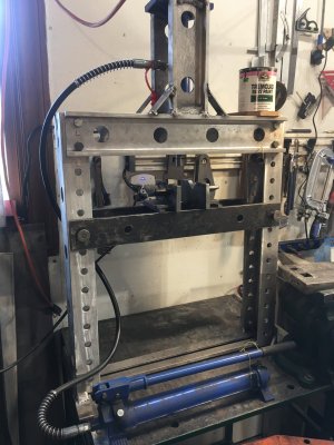

I commend you on your efforts to put together the training class. My input here is a bit late maybe but anyhow I think the many comments about safety are good advice. In my workspace (cramped corner of the garage), I don't have a picture of my ripped-off fingernail or one of my other ER trips. I do have this paint can permanently on display close to where I do most of my grinding. It's not bloody but speaks volumes. A few years ago a cut-off disc broke. A few moments later I saw a puddle of paint at the back of my bench. Since then my sometimes worn face shield is now close at hand and used whenever grinding, drilling, or doing other such activities.

@CWret That is a nice looking shop made press under the paint can. You make that one ?

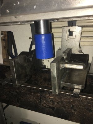

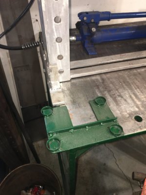

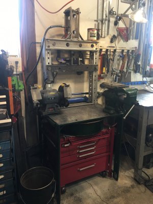

The hydraulics are a 10t Princess Auto port-a-power. Yes I made the press using salvaged 3x5/8" steel flat bar (Hwy bridge demo) and salvaged 3x4" aluminum channel (from RR bridge demo). The press frame was one of my first welding aluminum exercises using both my new spoolgun and some TIG. This new bench got my vise off of my fab bench where the vise always seemed to be in the way. The grinder sits on a sled that slides on a track on the edge of the bench. The grinder can be easily/quickly set aside and out of the way. The table is extra heavy construction because of the heavy combo vise/anvil, also I didn't want any cross members in the front.

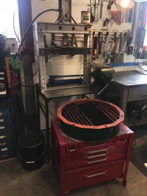

My plasma water table (top of 45 gal drum) and plasma tool cart neatly roll under the press/vise bench.
Nice cutting table. Does it have water in it?
Lotta welding for that top. That prolly won't be possible in my shop. Might be able to find or buy an old oven rack though.
First things first. Gotta see if that plasma cutter actually works first.
