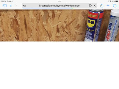

I tried opening the above image on my mac, safari, in a new window, and found I get a few lines of the top of the image but not the whole image. It then errors with a lost network connection.
Then I tried the same URL on my phone but only used the telecom network and turned off my wifi. It very slowly loaded the picture until nearly the end and then also failed with an error network connection lost. Screenshot below.
On my iPhone 14+
First try hung up with the loading bar 1 inch from the end.
Second try partly loaded
Third try hung up
Second try

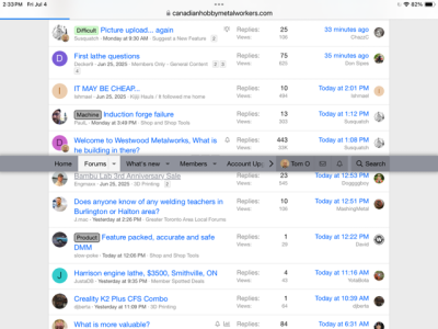

Probably not related but sitting here in Timmie’s I clicked on a link and saw something I never saw before the bar moving as I scrolled.
I turned the wifi off & on and it was back to normal WTF
Turning wifi off and on forces a refresh. I'd bet your browser was just hanging up. This kind of problem happens with or without a forum image problem.

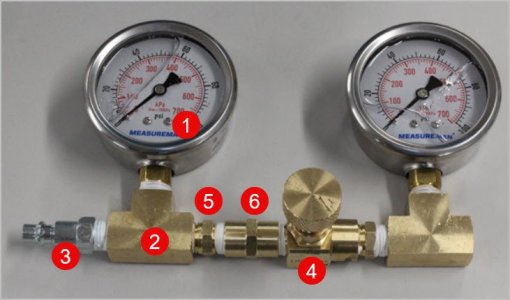

I just suggested size & type as an example culprits & I know you guys have pulled your hair out already. So if the subsequent image optimization is the culprit & buggering up the image so it cant be click viewed, isn't there some common thread or parameter as to what we can screen for or avoid uploading? Worded another way, I don't think (or at least nobody has complained) that they cant see my pictures. They are plain vanilla jpegs resized to max 500 pix just for posting convenience. Here is sample attached & embedded. So if this works across various browsers or hardware, what is uniquely different about these vs the problem pics?
embedded
