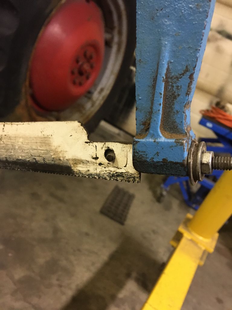

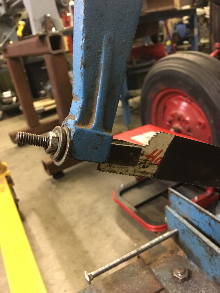

Got my PHS issue fixed or so I think.
I concocted this blade tensioner from a 5/8" bolt on my mill.
Makes a pretty square cut in both planes now. Not perfect but much better.
This is what was liberated squaring up the bad cut that the original blade tensioner caused. It was pretty bad.
Tomorrow I'll attempt to gut the swing using the saw.

Here you go. I chose 5/8" because I wanted lots of meat to thread the blade screw into. Probably over kill.
Without the top notch I found that it canted, so the notch was added to bring the nut bearing surface to the center of the arm slot (if that makes sense).
I'm really impressed with how square it cuts now.
