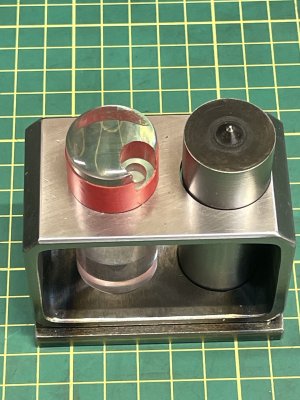

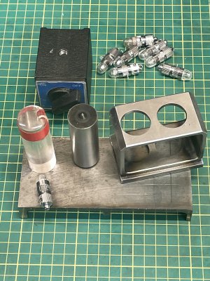

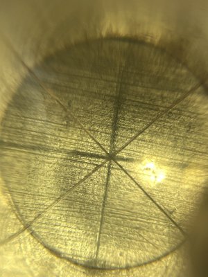

About a year ago I bought some acrylic 1” dowels to make an optical center punch. They just gathered dust until a few weeks ago. I finally got a roundtoit.
The little lights are designed for putting into party balloons before they are inflated.
Typical comments about these punches include:
1- by using proper techniques for center punching you don’t need one of these;
2- they don’t transmit enough light to see the cross hairs;
3- they are expensive;
4- they are even way more expensive if you can find one that has a light; and
5- not needed if you have a DRO.

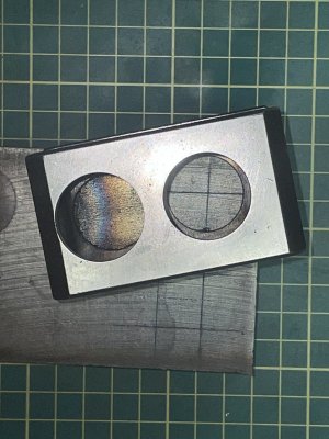

The $0.90 light bulb works great.

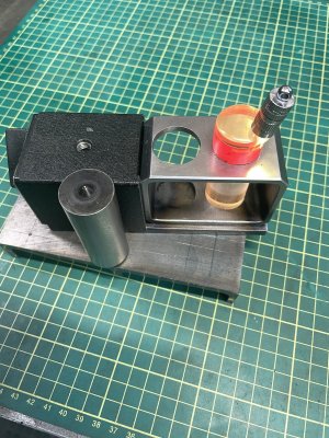

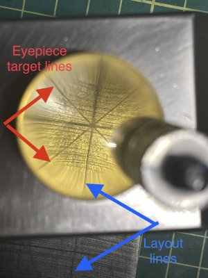

The magnetic base (from a test indicator kit) holds it on target while pulling out the dowel and putting in the punch. The V bottom helps if punching a pipe.
With the frame roughly located, then the dowel is installed and the magnetic base is partially switched on. Here is the view with the light on.
After final adjustments, switch the magnetic base fully on and then give it a punch.

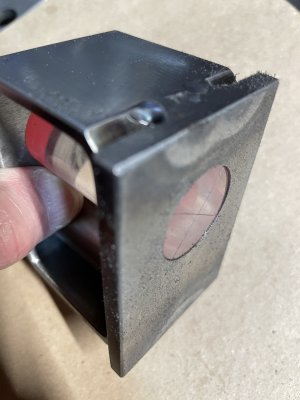

A center finder was used to cut the crosshairs into the dowel.
dowels:
lights:

My photo loading is very slow lately so I didn't really appreciate all the details of how you did this till just now after waiting for them all to load. Especially the light mount inset into the acrylic and the steel box holder and magnetic mount.

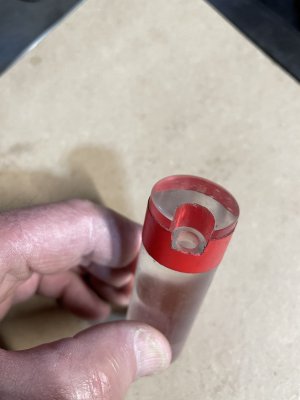

How did you polish the light recess?
I also seem to recall asking how you made the right curvature on the lens but I think that was in person and I've forgotten. Was it calculated or trial & error?
Light recess:
Drilled with a new carbide 10mm EM. It is a snug/tight fit for the bulb. This gives a flat bottom, so I deepened the hole with a new 3/16” drill bit to help diffuse the light.
For any cutting (after a lots of experimentation) I used new sharpe tooling at half the rpm you would use for steel with lots of thick lubricant:
The red tape keeps the dowel from falling out the bottom and also holds the dowel up 1/32” so it does not get scratched.
I experimented with the amount of curvature on the dowel. I think it is a personal preference thing - this one gives about a 2x magnification.
