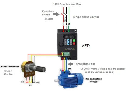

So if I have it right I don't need to cal in an electrician to change the ehisting 230V wiring from my house panel to the outlet in my garage?
The switch to 3ph comes with the new motor etc., is updated somewhere after that. Am I correct with that in my little pea brain?
uh... perhaps. I'm not sure what changes you have in mind. (perhaps I have missed it)
Yes, you use a normal 220V plug, wired to a VFD box, and you have 3PH electricity wired from that box directly to your motor.

Sometimes a picture is better than words. This does not show every detail for example there would also be a start and stop button connected to the VFD,
@Dusty - I like Slow Pokes idea of a picture. Your hookup doesn't even need the potentiometer because there is one on the VFD. You really just need single phase in and 3ph out to the motor.
Or you can add a remote one like he has shown. Depending on the feature set of your VFD, you can usually also add a braking resistor, a fwd/rev/stop switch, a jog switch, Etc. Etc
You can also program the VFD for minimum frequency, max frequency, accel and decel rate, etc etc.
So a VFD is more than just a way to run a 3ph motor at variable speeds on a single phase system. It can also be a very sophisticated motor control system.
If you are only going to have that one unit using 220v, then put a safety switch before the VFD. The Canadian Electrical Code wants you to have a motor disconnect within eye-sight of the motor.
If you plan on having multiple motors and electrical, you can put a breaker panel in the garage, and then wire all the garage electrical to that panel (not necessary, but handy).
